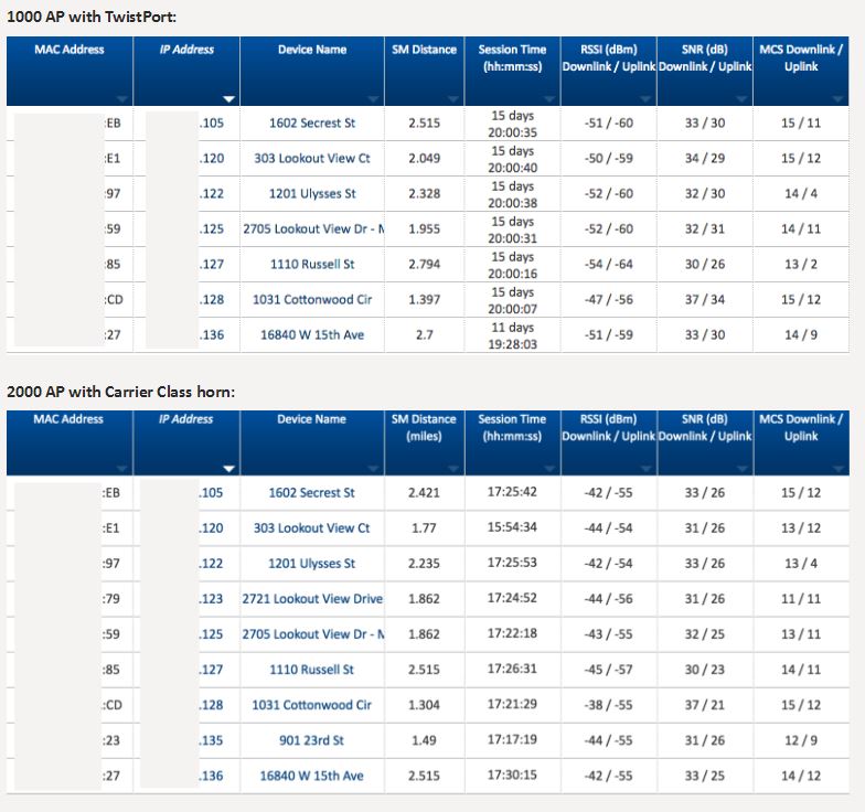

jan.sabados Posted October 31, 2016 Posted October 31, 2016 Если кто-то заинтересован в результаты сравнения ePMP 1000 vs. ePMP 2000: http://community.cambiumnetworks.com/t5/ePMP-2000-and-1000/ePMP-1000-gt-2000-test-results/m-p/61260#U61260 Они использовали эти антенны: http://www.rfelements.com/products/antennas/symmetrical-horn-carrier-class/symmetrical-horn-carrier-class/ http://www.rfelements.com/products/wireless-broadband/symmetrical-horn-antennas/symmetrical-horn-tp-antenna/
