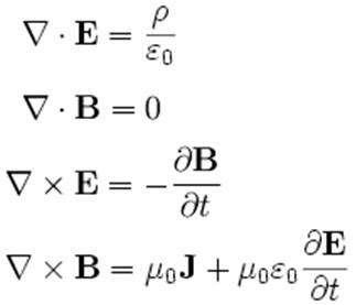

Maxwell’s Equations may be resolved into two
Partial Differential Equations of Second Order
• Maxwell’s Equations
• Resulting Wave Equations
They are LINEAR equations, and so superposition holds for
multiple waves, which add linearly at any point.
