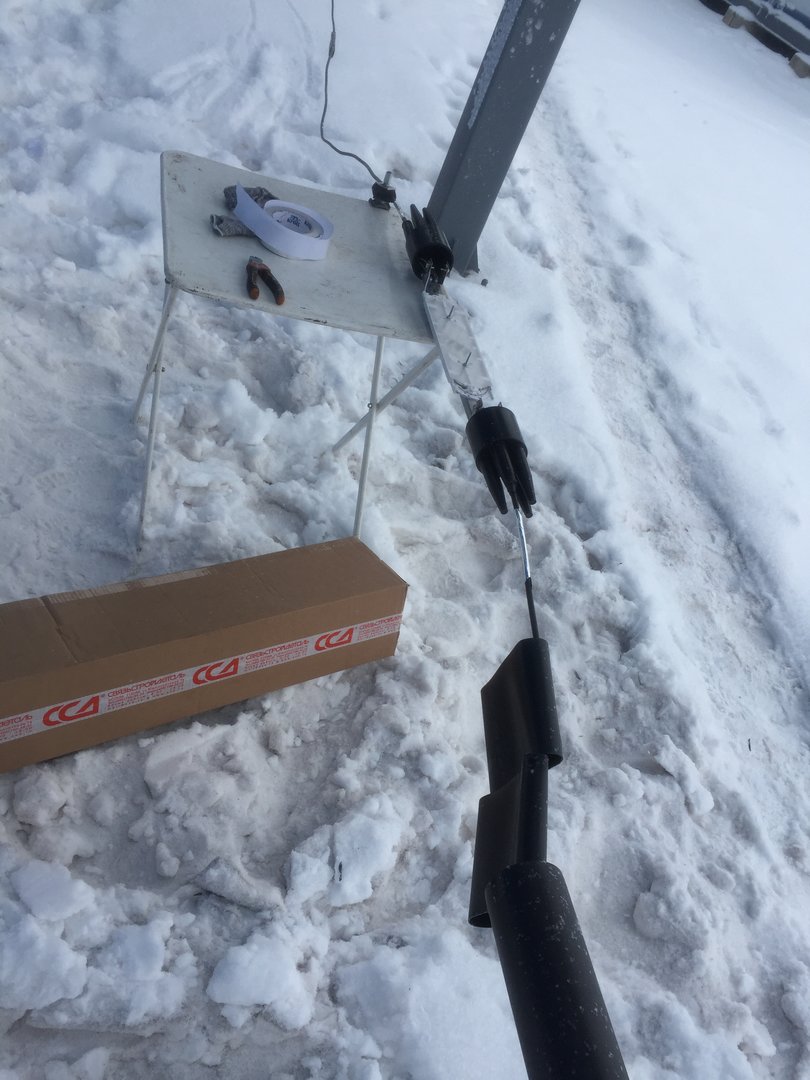

Lexandr_kaz Posted April 28, 2019 Posted April 28, 2019 (edited) -10 AI-7 Edited April 28, 2019 by Lexandr_kaz Вставить ник Quote
root_1 Posted April 28, 2019 Posted April 28, 2019 1 час назад, Lexandr_kaz сказал: -10 AI-7 А палатка, не ? Вставить ник Quote
