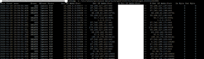

felixio_01 Опубликовано 23 января, 2020 Здравствуйте! Подскажите, в чём может быть проблема? В nfsen не отображаются графики в "Packets" и "Traffic". Графики "Flows" нормально отображаются. uname -a Linux gw3 3.16.0-4-amd64 #1 SMP Debian 3.16.51-3 (2017-12-13) x86_64 GNU/Linux nfsen-1.3.8 /usr/local/bin/nfdump: Version: NSEL-NEL1.6.18 modinfo -F version ipt_NETFLOW 2.4-12-g1519063 cat /etc/modprobe.d/ipt_NETFLOW.conf options ipt_NETFLOW destination=127.0.0.1:2055 protocol=9 natevents=1 sysctl -a | grep net.netflow net.netflow.active_timeout = 1800 net.netflow.aggregation = net.netflow.debug = 0 net.netflow.destination = 127.0.0.1:2055 net.netflow.flush = 0 net.netflow.hashsize = 491666 net.netflow.inactive_timeout = 15 net.netflow.maxflows = 2000000 net.netflow.natevents = 1 net.netflow.promisc = 0 net.netflow.protocol = 9 net.netflow.refresh-rate = 20 net.netflow.scan-min = 1 net.netflow.sndbuf = 16777216 net.netflow.timeout-rate = 30 ps -aux |grep nfcapd www-data 26689 0.0 0.1 40908 4528 ? S 11:25 0:00 /usr/local/bin/nfcapd -w -D -p 2055 -u www-data -g www-data -B 200000 -S 1 -P /etc/nfsen/var/run/p2055.pid -z -I gw3 -l /etc/nfsen/profiles-data/live/gw3 cat /etc/nfsen/etc/nfsen.conf $BASEDIR = "/etc/nfsen"; $LIBEXECDIR="${BASEDIR}/libexec"; $CONFDIR="${BASEDIR}/etc"; $HTMLDIR = "/var/www/nfsen/"; $DOCDIR="${HTMLDIR}/doc"; $VARDIR="${BASEDIR}/var"; $PROFILESTATDIR="${BASEDIR}/profiles-stat"; $PROFILEDATADIR="${BASEDIR}/profiles-data"; $BACKEND_PLUGINDIR="${BASEDIR}/plugins"; $FRONTEND_PLUGINDIR="${HTMLDIR}/plugins"; $PREFIX = '/usr/local/bin'; $USER = "www-data"; $WWWUSER = "www-data"; $WWWGROUP = "www-data"; $BUFFLEN = 200000; $SUBDIRLAYOUT = 1; $ZIPcollected = 1; $ZIPprofiles = 1; $PROFILERS = 2; $DISKLIMIT = 98; $PROFILERS = 6; %sources = ( 'gw3' => { 'port' => '2055', 'col' => '#0000ff', 'type' => 'netflow' }, ); $low_water = 90; $syslog_facility = 'local3'; @plugins = ( # profile # module # [ '*', 'demoplugin' ], ); %PluginConf = ( # For plugin demoplugin demoplugin => { # scalar param2 => 42, # hash param1 => { 'key' => 'value' }, }, # for plugin otherplugin otherplugin => [ # array 'mary had a little lamb' ], ); $MAIL_FROM = 'aeldarr@yandex.ru'; $SMTP_SERVER = 'localhost'; $MAIL_BODY = q{ Alert '@alert@' triggered at timeslot @timeslot@ }; 1; Вставить ник Цитата Ответить с цитированием Поделиться сообщением Ссылка на сообщение Поделиться на других сайтах More sharing options...
zhenya` Опубликовано 23 января, 2020 Вы собираете натевенты. Вставить ник Цитата Ответить с цитированием Поделиться сообщением Ссылка на сообщение Поделиться на других сайтах More sharing options...
felixio_01 Опубликовано 24 января, 2020 (изменено) 15 часов назад, zhenya` сказал: Вы собираете натевенты. Подскажите, что нужно исправить, что бы собиралась статистика и по трафику? Изменено 24 января, 2020 пользователем felixio_01 Вставить ник Цитата Ответить с цитированием Поделиться сообщением Ссылка на сообщение Поделиться на других сайтах More sharing options...
pppoetest Опубликовано 24 января, 2020 Нет ни одной записи с байтами? Вставить ник Цитата Ответить с цитированием Поделиться сообщением Ссылка на сообщение Поделиться на других сайтах More sharing options...
felixio_01 Опубликовано 24 января, 2020 2 часа назад, pppoetest сказал: Нет ни одной записи с байтами? нет. Вставить ник Цитата Ответить с цитированием Поделиться сообщением Ссылка на сообщение Поделиться на других сайтах More sharing options...
