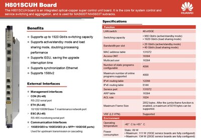

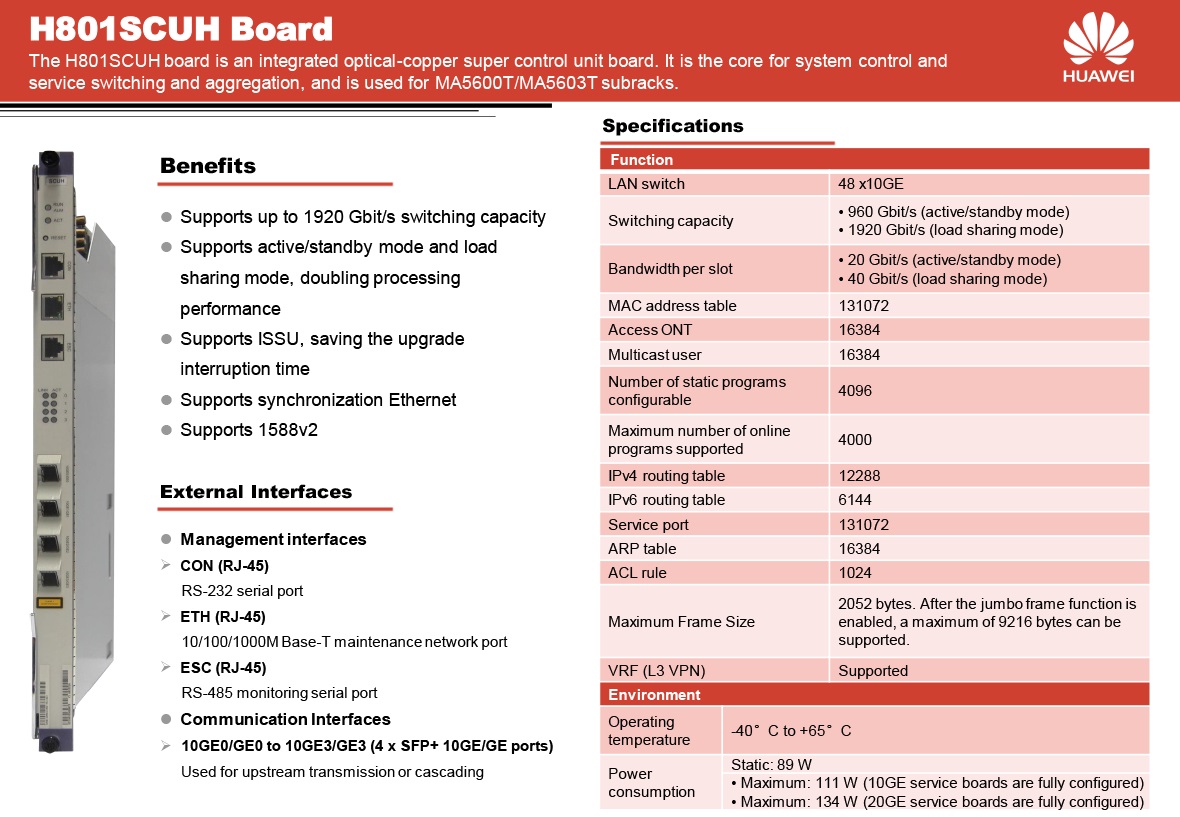

  1. H801SCUH - 4 GE/10GE ports, Supporting automati c switching for remote software commissioning using GE upstream transmission. The H801X2CS board is a 2-port 10GE uplink interface card that provides two 10GE upstream or cascading optical ports. The H802X2CS board is a 2-port 10GE/GE uplink interface card that provides two 10GE/GE upstream or cascading optical ports. какие у вас цели?
