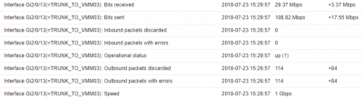

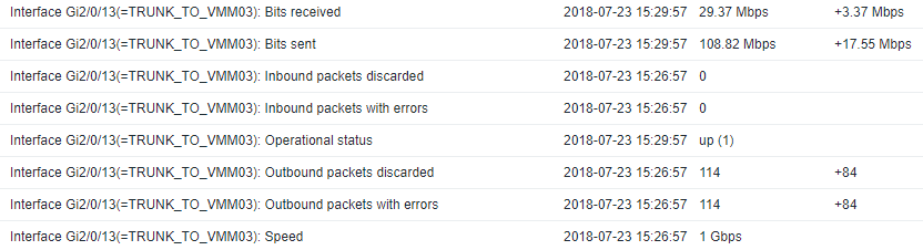

Приветствую.
Подскажите в чем может быть причина большого кол-ва ошибок Output на портах объединенных в Port-channel. Коммутаторы два WS-C3850R-24T объединенных в стэк? На другом конце сервер hp.

Cisco IOS Software, IOS-XE Software, Catalyst L3 Switch Software (CAT3K_CAA-UNIVERSALK9-M), Version 03.07.04E RELEASE SOFTWARE (fc1)
Трафика не много. Есть на картинке выше.
Весь конфиг нет. Частями да. Говорите что надо.

  5 minute input rate 26996000 bits/sec, 3498 packets/sec
  5 minute output rate 49204000 bits/sec, 8300 packets/sec
     74093477214 packets input, 86288293528115 bytes, 0 no buffer
     Received 8930773 broadcasts (2275337 multicasts)
     0 runts, 0 giants, 0 throttles
     0 input errors, 0 CRC, 0 frame, 0 overrun, 0 ignored
     0 watchdog, 2275337 multicast, 0 pause input
     0 input packets with dribble condition detected
     149986920090 packets output, 125478909825347 bytes, 0 underruns
     854448306 output errors, 0 collisions, 1 interface resets
     0 unknown protocol drops
     0 babbles, 0 late collision, 0 deferred
     0 lost carrier, 0 no carrier, 0 pause output
     0 output buffer failures, 0 output buffers swapped out
c3850_Core#sh int gi2/0/13
GigabitEthernet2/0/13 is up, line protocol is up (connected)
  Hardware is Gigabit Ethernet, address is 2852.6119.f28d (bia 2852.6119.f28d)
  Description: =TRUNK_TO_VMM03
  MTU 1500 bytes, BW 1000000 Kbit/sec, DLY 10 usec,
     reliability 255/255, txload 15/255, rxload 6/255
  Encapsulation ARPA, loopback not set
  Keepalive set (10 sec)
  Full-duplex, 1000Mb/s, media type is 10/100/1000BaseTX
  input flow-control is off, output flow-control is unsupported
  ARP type: ARPA, ARP Timeout 04:00:00
  Last input 00:00:18, output never, output hang never
  Last clearing of "show interface" counters never
  Input queue: 0/2000/0/0 (size/max/drops/flushes); Total output drops: 2336868113
  Queueing strategy: fifo
  Output queue: 0/40 (size/max)
  5 minute input rate 26425000 bits/sec, 3451 packets/sec
  5 minute output rate 60441000 bits/sec, 8961 packets/sec
     74054185647 packets input, 86206567465690 bytes, 0 no buffer
     Received 9299854 broadcasts (2286429 multicasts)
     0 watchdog, 2286429 multicast, 0 pause input
     165243787777 packets output, 159938463941332 bytes, 0 underruns
     2336868113 output errors, 0 collisions, 1 interface resets
