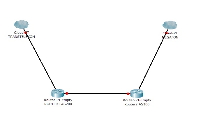

DruGoe_DeLo Posted December 6, 2012 Author Posted December 6, 2012 (edited) И так. На рисунке показана физическая схема соединения. (на красные точки не обращайте внимания рисовал схемку в эмуляторе). И так. router 1 AS200 имеет следующие настройки. router bgp 200 no synchronization bgp log-neighbor-changes network 88.168.86.0 mask 255.255.240.0 network 98.227.210.0 mask 255.255.255.0 network 98.227.211.0 mask 255.255.255.0 network 98.227.228.0 mask 255.255.255.0 neighbor 189.43.47.242 remote-as 200 neighbor 189.43.47.242 weight 65000 neighbor 219.150.47.30 remote-as ASTRANS neighbor 219.150.47.30 weight 65500 neighbor 219.150.47.30 prefix-list DEFAULT in neighbor 219.150.47.30 prefix-list OUT-out out no auto-summary ip route 88.161.16.0 255.255.240.0 Null0 254 ip route 98.227.210.0 255.255.255.0 Null0 254 ip route 98.227.211.0 255.255.255.0 Null0 254 ip route 98.227.228.0 255.255.255.0 Null0 254 ip prefix-list DEFAULT seq 5 permit 0.0.0.0/0 ip prefix-list OUT-out seq 5 permit 98.227.228.0/24 ip prefix-list OUT-out seq 10 permit 98.227.210.0/24 ip prefix-list OUT-out seq 15 permit 98.227.211.0/24 ip prefix-list OUT-out seq 20 permit 88.161.16.0/20 ip prefix-list OUT-out seq 25 permit 38.138.184.0/21 # это я делаю для того чтобы было разрешено выход в интернет нашим соседям через нас (загоняю всю ихнию подсеть) #sh ip bgp Network Next Hop Metric LocPrf Weight Path *> 0.0.0.0 219.150.47.30 0 65500 ASTRANS i *> 38.138.184.0/23 189.43.47.242 0 65000 100 i *> 88.161.16.0/20 0.0.0.0 0 32768 i *> 98.227.210.0/24 0.0.0.0 0 32768 i *> 98.227.211.0/24 0.0.0.0 0 32768 i *> 98.227.228.0/24 0.0.0.0 0 32768 i на роуторе 2 AS100 следующие астройки router bgp 100 bgp log-neighbor-changes bgp bestpath as-path multipath-relax network 38.138.184.0 mask 255.255.254.0 network 38.138.186.0 mask 255.255.254.0 network 38.138.188.0 mask 255.255.252.0 neighbor 58.25.65.105 remote-as ASMFN neighbor 58.25.65.105 prefix-list BGP-IN in neighbor 58.25.65.105 prefix-list BGP-OUT out neighbor 189.43.47.241 remote-as 200 neighbor 189.43.47.241 prefix-list BGP-OUT-as200 out maximum-paths 2 Ну вроде все как говориться ок. Я хочу чтобы 1 подсеть ходила через AS200 в интернет ASTRANS Транслируемая сеть поделена на подсети для раздачи IP юрикам и физикам ip route 38.138.184.0 255.255.254.0 Null0 254 ip route 38.138.186.0 255.255.254.0 Null0 254 ip route 38.138.188.0 255.255.252.0 Null0 254 ip prefix-list BGP-IN seq 5 permit 0.0.0.0/0 ! ip prefix-list BGP-OUT seq 5 permit 38.138.186.0/23 ip prefix-list BGP-OUT seq 10 permit 38.138.188.0/22 ! ip prefix-list BGP-OUT-as200 seq 5 permit 38.138.184.0/23 #sh ip bgp *m 0.0.0.0 188.43.47.241 *> 58.25.65.105 *> 38.138.184.0/23 0.0.0.0 *> 38.138.186.0/23 0.0.0.0 *> 38.138.188.0/22 0.0.0.0 *> 88.161.16.0/20 189.43.47.241 *> 98.227.210.0/24 189.43.47.241 *> 98.227.211.0/24 189.43.47.241 *> 98.227.228.0/24 189.43.47.241 При таком раскладе и судя по графика получается что через MFN инет входит а через TRANS выходит... Кароче я уже сломал голову. Точнее у меня падают подозрения что провайдер TRANS рубит подсети AS100. P.S. IP изменены или придуманы. Edited December 6, 2012 by DruGoe_DeLo Вставить ник Quote
