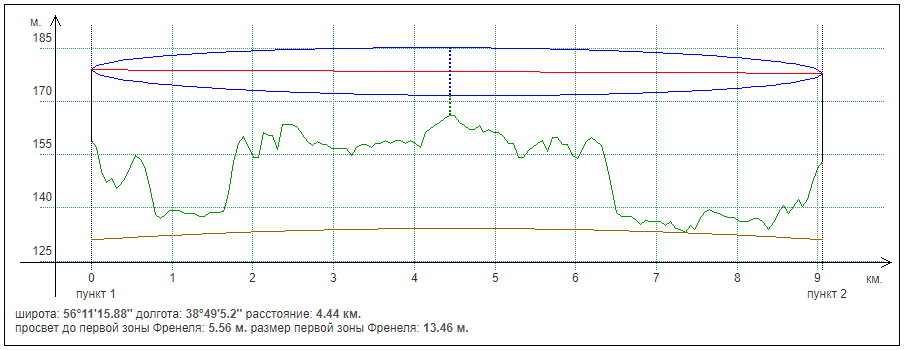

iXapek Posted February 20, 2019 Author Posted February 20, 2019 (edited) Профиль радиолинии Edited February 20, 2019 by iXapek Вставить ник Quote
