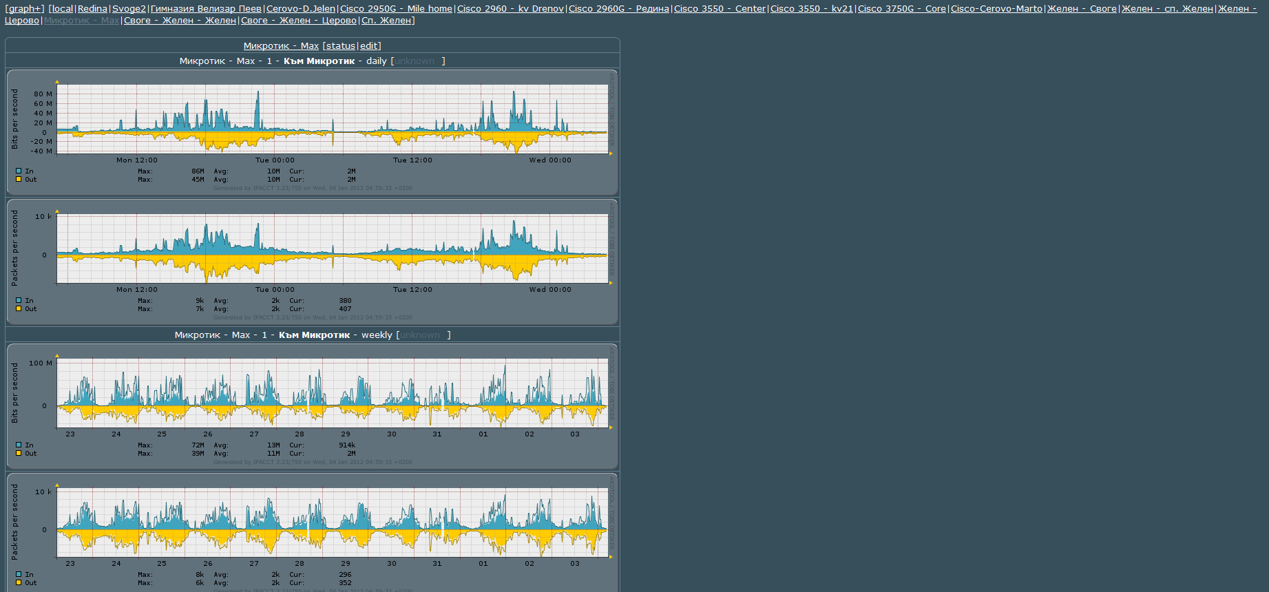

450G
without conntrack
no shape
80/40mbps
9/7k pps
40-50% load
shape ----> RB711G-5HnD ---------> N link 3km | 433AH x2 N wlan | N link 3.3km -------------> RB711G-5HnD ------> 450G (23 vlan, 50 customers)
ROS 5.11
