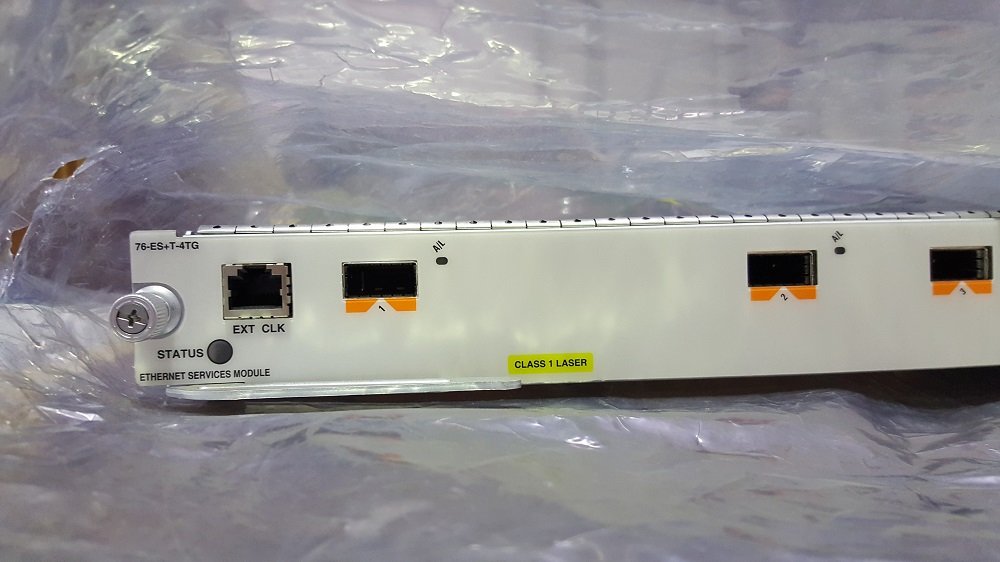

Garra-67 Posted December 27, 2017 Posted December 27, 2017 Есть 76-ES+T-4TG, при впихивании циклически крутится ошибка и модуль ребутается. *Jan 2 03:16:00.567: %FABRIC_INTF_ASIC-DFC3-5-FABRICSYNC_DONE: Fabric ASIC 0 Channel 1: Fabric sync done. *Jan 2 03:16:00.603: %FABRIC_INTF_ASIC-DFC3-5-FABRICSYNC_DONE: Fabric ASIC 1 Channel 1: Fabric sync done. *Jan 2 03:16:03.791: %DIAG-SP-6-RUN_MINIMUM: Module 3: Running Minimal Diagnostics... *Jan 2 03:17:51.791: %PM_SCP-SP-1-LCP_FW_ERR: System resetting module 3 to recover from error: x40g_crashinfo_init: Linecard received system exception *Jan 2 03:17:51.791: %OIR-SP-3-PWRCYCLE: Card in module 3, is being power-cycled Off (Module Reset due to exception or user request) *Jan 2 03:17:51.903: %C7600_PWR-SP-4-DISABLED: power to module in slot 3 set Off (Module Reset due to exception or user request) Проблема памяти на самом модуле, бобик сдох? Сьемный модуль ddr менял, ios другой заливал. Вставить ник Quote
Telesis Posted December 27, 2017 Posted December 27, 2017 Дохнут эти карты от перегрева как мухи... Вставить ник Quote

Garra-67 Posted March 12, 2018 Author Posted March 12, 2018 (edited) Плата модульная, перебрал, поставил другой DFC, но он LITE. Работает. Edited February 29, 2020 by Garra-67 Вставить ник Quote
