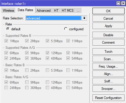

set 0 band=2ghz-b/g/n channel-width=20/40mhz-ht-above comment="Wlan" disabled=no frequency=2452 frequency-mode=superchannel ht-guard-interval=long ht-rxchains=\
   0,1 ht-txchains=0,1 hw-protection-mode=rts-cts hw-retries=15 l2mtu=2290 mode=ap-bridge periodic-calibration=enabled periodic-calibration-interval=10 security-profile=\
   "WiFi" tx-power-mode=all-rates-fixed wds-default-bridge=bridge2 wds-mode=dynamic wireless-protocol=802.11
и с учетом что вот так как на скрине
