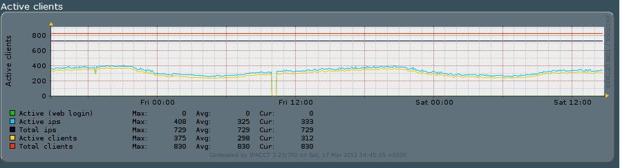

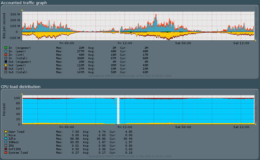

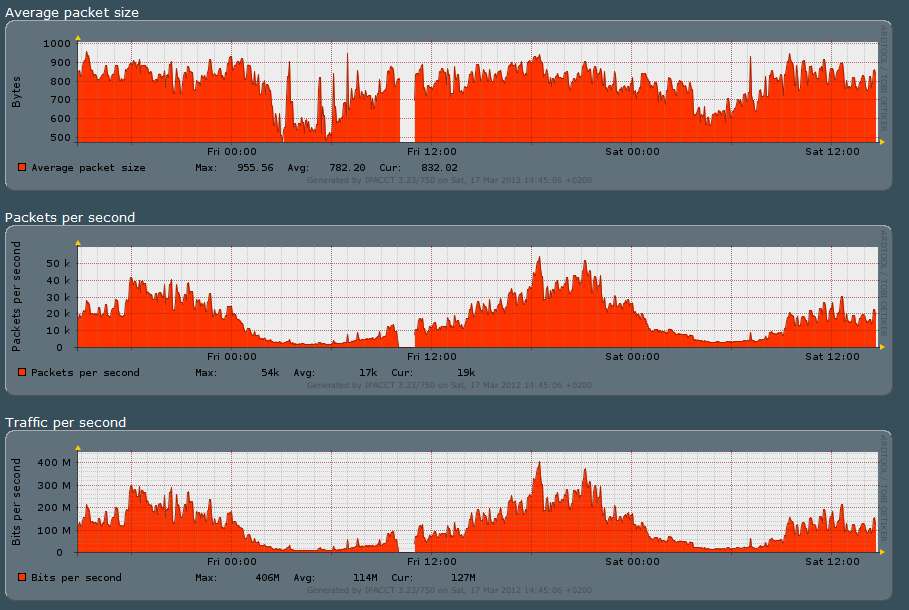

whitenoise Posted June 16, 2012 Posted June 16, 2012 (edited) d510 у меня 2x /24 400 user max Edited June 16, 2012 by whitenoise Вставить ник Quote
