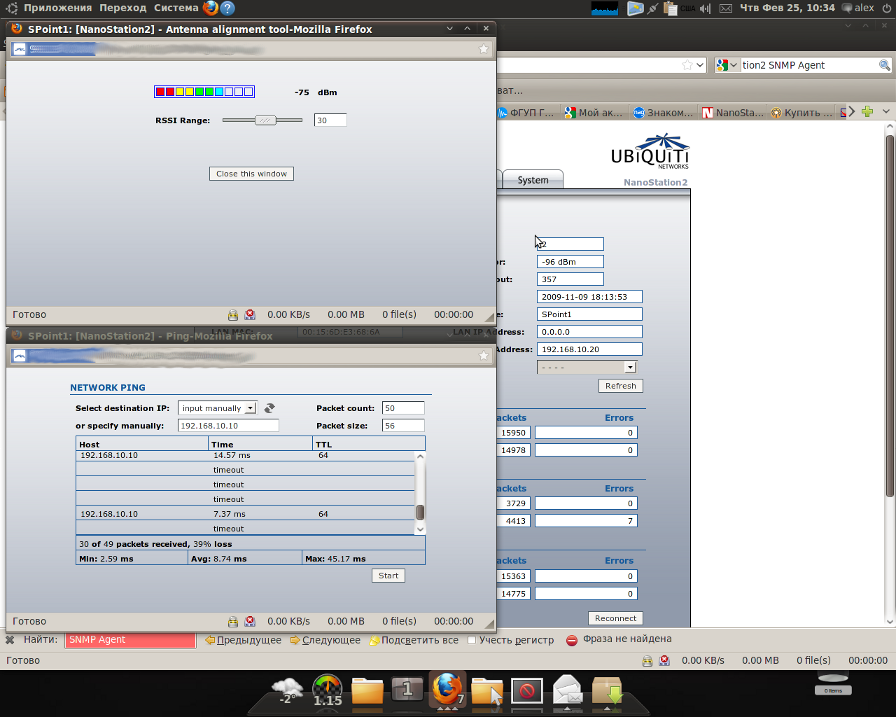

Уровень сигнала 73-75
но пинг вот:

30 of 49 packets received, 39% loss
Min: 2.59 ms     Avg: 8.74 ms     Max: 45.17 ms

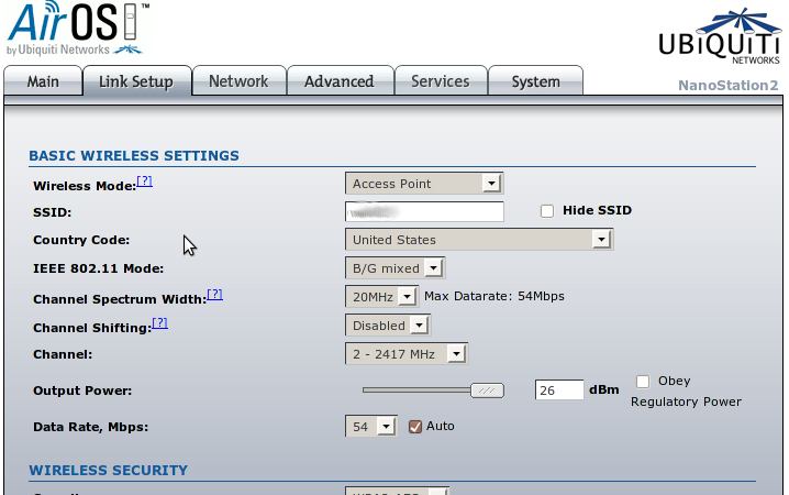

Настройки линка
Wireless Mode:[?]  Access Point
SSID:         Hide SSID
Country Code:
IEEE 802.11 Mode: B/G MIX
Channel Spectrum Width:[?] 20MHz     Max Datarate: 54Mbps
Channel Shifting:[?]     (Disable)
Channel:
Output Power:     26 dBm     Obey Regulatory Power (Disable)
Data Rate, Mbps: 54    Auto
Advanced Wireless Settings
Rate Algorithm:     EWMA
Noise Immunity:     Enabled - (Disabled)
RTS Threshold:     Off
Fragmentation Threshold:     Off

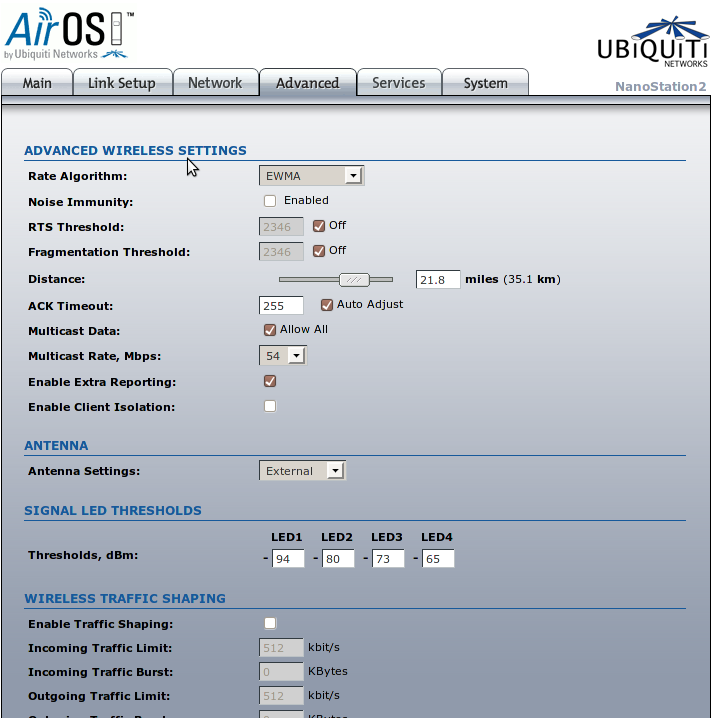

Distance:     21.8    miles (35.1 km)
ACK Timeout: 255  Auto Adjust (Enabled)
Multicast Data:     Allow All (Enabled)
Multicast Rate, Mbps:     54
Enable Extra Reporting: (Enabled)
Enable Client Isolation: (Disabled)
На второй точке (клиенте) настройки те же самые.
но пинг вот:
Настройки линка
SSID:         Hide SSID
Country Code:
Channel:
RTS Threshold:     Off
