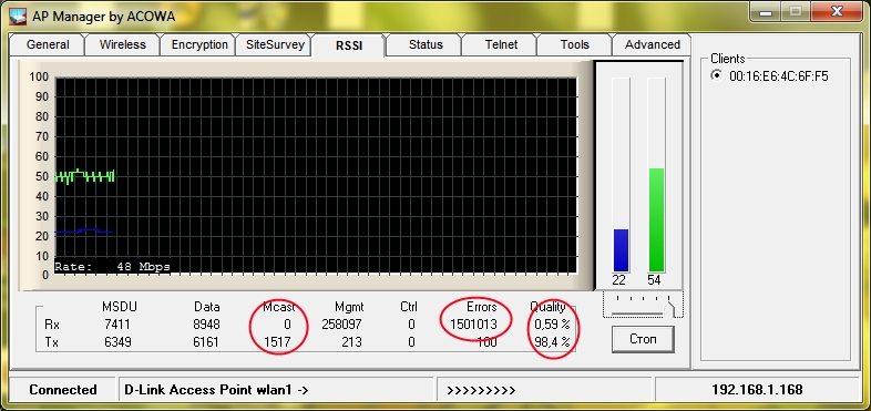

tofu Posted November 11, 2009 Author Posted November 11, 2009 (edited) Прошил в ББ пока только AP, в целом доволен, но началась вот такая пляска со стороны клиента, по-моему это ненормально. в чем причина?... блин, немогу прикрепить картинку... вот она Вот конфиг клиента: D-Link Access Point wlan1 -> get config wlan1 revisions: mac 5.8 phy 4.4 analog 4.6 PCI Vendor ID: 0x168c, Device ID: 0x13 Sub Vendor ID: 0x168c, Sub Device ID: 0x13 chip is AR2312 Country Code: GB Operation Mode: Wireless Client Remote AP: 00:21:91:7E:CC:32 Wlan State: Enabled Radio Frequency: 2457 MHz (IEEE 10) Wireless LAN Mode: 802.11g Auto Channel Select: Disabled Extended Channel Mode: Enabled Data Rate: 6 Antenna: 1 Login Username: admin RADIUS address: Name server IP address: Name server domain suffix: SSID: ex-link SSID Suppress Mode: Disabled System Name: D-Link Access Point Beacon Interval: 100 DTIM: 1 Fragmentation Threshold: 2346 RTS/CTS Threshold: 2346 Short Preamble: Disabled 11g Only Allowed: Disabled CTS Mode: AUTO CTS Rate: 11 Mbps CTS Type: CTS-ONLY 11g Overlapping BSS Protection: Disabled 11g Beacon Rate: 1 Mbps 11g Draft 5.0 compatibility: Disabled Short Slot Time: Enabled Basic 11g Rate Set: (1, 2, 5.5, 11) 11g Optimization Level: 1 Burst Time: 2 Burst Sequence Threshold: 3 IP Address: 192.168.1.201 IP Mask: 255.255.255.0 Host IP Address: 0.0.0.0 Gateway IP Address: 192.168.1.1 SNTP/NTP Server IP Address: Time Zone: 27 HW Transmit Retry Limit: 4 SW Transmit Retry Limit: 3 TransmitPower: full Current Transmit Output Power 21.0 dBm SuperG :Disabled Encryption: Disabled Cipher selection: WEP Authentication Type: Open-System Default transmit key: 1 Shared Key 1, size 40, 0000000000 Access Check: Disabled Key Entry Method: hexadecimal Group Key Update Interval: 1800 seconds Key Source: flash Aging Interval: 300 seconds Calibration Period: 30 seconds Software Retry: Enabled WDS: Enabled Watchdog: Enabled Telnet Access: Enabled Telnet Timeout: 180 seconds Minimum rate: 1 Mbps XR Poll interval: 100 msec XR Frame Limit: 25 XR Poll Rate String is 0.25 1 1 3 3 6 6 20 XR Fragmentation Threshold: 540 D-Link Access Point wlan1 -> Пробовал Current Transmit Output Power ставить 17.0 dBm и 19.0 dBm ставновиться значительно хуже. Edited November 11, 2009 by tofu Вставить ник Quote

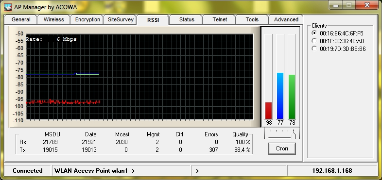

tofu Posted November 11, 2009 Author Posted November 11, 2009 Хотя со стороны AP прошитой в ББ, все намного лучше.. чото я ничего непонимаю: Вставить ник Quote
SSD Posted November 11, 2009 Posted November 11, 2009 Хотя со стороны AP прошитой в ББ, все намного лучше.. чото я ничего непонимаю: Наличие ошибок вполне нормально. То что ухудшается связь при снижение мощности, говорит о том что ваши антенны никакие. Вставить ник Quote
tofu Posted November 11, 2009 Author Posted November 11, 2009 Y Наличие ошибок вполне нормальноДаже такого количества? Вставить ник Quote
SSD Posted November 11, 2009 Posted November 11, 2009 YНаличие ошибок вполне нормальноДаже такого количества? Да. Вставить ник Quote
