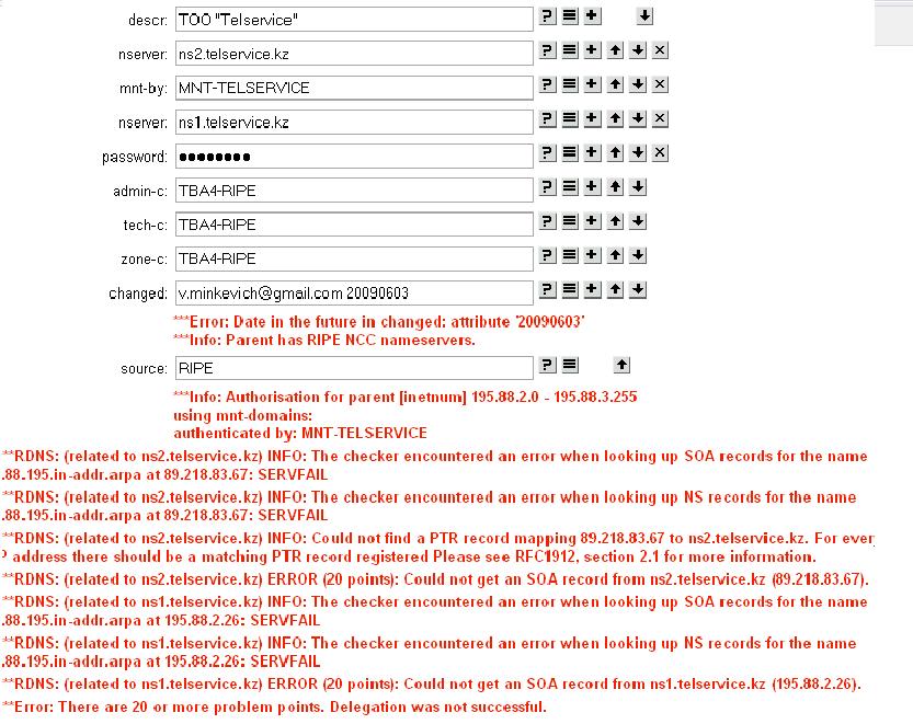

Здравствуйте. Не получается создать PTR запись никак...
вырезка из named.conf
zone "2.88.195.in-addr.arpa" IN {
        type master;
        file "195.88.2";
        allow-update { none; };
вырезка из файла 195.88.2
$TTL    86400
2.88.195.in-addr.arpa.   IN      SOA     telservice.kz. administrator.telservice.kz.  (
                                      2009060311; Serial
                                      28800    ; Refresh
                                      14400    ; Retry
                                      1296000  ; Expire
                                      86400 )  ; Minimum
        IN      NS      ns1.telservice.kz.
        IN      NS      ns2.telservice.kz.
10      IN      PTR     xxxxxxxx.kz.
в Ripe выходят ошибки при добавлении объекта domain:
***RDNS: (related to ns2.telservice.kz) INFO: The checker encountered an error when looking up SOA records for the name 2.88.195.in-addr.arpa at 89.218.83.67: SERVFAIL
***RDNS: (related to ns2.telservice.kz) INFO: The checker encountered an error when looking up NS records for the name 2.88.195.in-addr.arpa at 89.218.83.67: SERVFAIL
***RDNS: (related to ns2.telservice.kz) INFO: Could not find a PTR record mapping 89.218.83.67 to ns2.telservice.kz. For every IP address there should be a matching PTR record registered Please see RFC1912, section 2.1 for more information.
***RDNS: (related to ns2.telservice.kz) ERROR (20 points): Could not get an SOA record from ns2.telservice.kz (89.218.83.67).
***RDNS: (related to ns1.telservice.kz) INFO: The checker encountered an error when looking up SOA records for the name 2.88.195.in-addr.arpa at 195.88.2.26: SERVFAIL
***RDNS: (related to ns1.telservice.kz) INFO: The checker encountered an error when looking up NS records for the name 2.88.195.in-addr.arpa at 195.88.2.26: SERVFAIL
***RDNS: (related to ns1.telservice.kz) ERROR (20 points): Could not get an SOA record from ns1.telservice.kz (195.88.2.26).
***Error: There are 20 or more problem points. Delegation was not successful.
Как решить - понять не могу... конфиг уже много раз менял...
P.S. В приложении - то, что я заполнил на сайте ripe.
Спасибо Вам.
Edited by Minkevich
