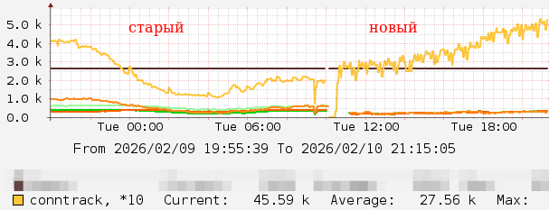

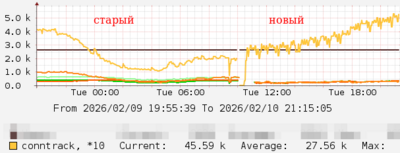

alex39x Posted February 11 Posted February 11 (edited) Подскажите. Вводим в эксплуатацию новый сервер. При переносе трафика со старого сервера на новый странное поведение conntrack - растёт каждые 2 минуты и падает.Дельта примерно 10К. Таймауты перенесли со старого. NAT на iptables - правила перенесли со старого сервера. Сервера в плане железа и софта разные. Скрытый текст новый Wed Feb 11 11:32:50 UTC 2026 19757 Wed Feb 11 11:33:10 UTC 2026 23083 Wed Feb 11 11:33:30 UTC 2026 26346 Wed Feb 11 11:33:50 UTC 2026 28631 Wed Feb 11 11:34:10 UTC 2026 29730 Wed Feb 11 11:34:30 UTC 2026 30240 Wed Feb 11 11:34:50 UTC 2026 31337 Wed Feb 11 11:35:10 UTC 2026 23805 Wed Feb 11 11:35:30 UTC 2026 26215 Wed Feb 11 11:35:50 UTC 2026 28622 Wed Feb 11 11:36:10 UTC 2026 29756 Wed Feb 11 11:36:30 UTC 2026 30832 Wed Feb 11 11:36:50 UTC 2026 32055 Wed Feb 11 11:37:10 UTC 2026 25125 Wed Feb 11 11:37:30 UTC 2026 27851 Wed Feb 11 11:37:50 UTC 2026 29433 Wed Feb 11 11:38:10 UTC 2026 30455 Wed Feb 11 11:38:30 UTC 2026 31506 Wed Feb 11 11:38:50 UTC 2026 32005 Wed Feb 11 11:39:10 UTC 2026 22614 старый while true; do date ; conntrack -C; sleep 20; done Wed Feb 11 12:01:16 UTC 2026 22115 Wed Feb 11 12:01:36 UTC 2026 21863 Wed Feb 11 12:01:56 UTC 2026 22060 Wed Feb 11 12:02:16 UTC 2026 21625 Wed Feb 11 12:02:36 UTC 2026 21457 Wed Feb 11 12:02:56 UTC 2026 21364 Wed Feb 11 12:03:16 UTC 2026 21404 Wed Feb 11 12:03:36 UTC 2026 21193 Wed Feb 11 12:03:56 UTC 2026 21382 Wed Feb 11 12:04:16 UTC 2026 20836 Wed Feb 11 12:04:36 UTC 2026 20092 Wed Feb 11 12:04:56 UTC 2026 20934 Wed Feb 11 12:05:16 UTC 2026 21778 Wed Feb 11 12:05:36 UTC 2026 21226 Wed Feb 11 12:05:56 UTC 2026 21577 Wed Feb 11 12:06:16 UTC 2026 21571 Wed Feb 11 12:06:36 UTC 2026 21744 Wed Feb 11 12:06:56 UTC 2026 20955 Wed Feb 11 12:07:16 UTC 2026 И ещё не понимаю - когда запускаю conntrack -L - счётчик соединений уменьшается: conntrack -C ; conntrack -L | wc -l; conntrack -C 25240 conntrack v1.4.6 (conntrack-tools): 19858 flow entries have been shown. 19858 19869 как посмотреть что там растёт sysctl: Скрытый текст net.netfilter.nf_conntrack_acct = 1 net.netfilter.nf_conntrack_buckets = 131072 net.netfilter.nf_conntrack_checksum = 1 net.netfilter.nf_conntrack_count = 29666 net.netfilter.nf_conntrack_dccp_loose = 1 net.netfilter.nf_conntrack_dccp_timeout_closereq = 64 net.netfilter.nf_conntrack_dccp_timeout_closing = 64 net.netfilter.nf_conntrack_dccp_timeout_open = 43200 net.netfilter.nf_conntrack_dccp_timeout_partopen = 480 net.netfilter.nf_conntrack_dccp_timeout_request = 240 net.netfilter.nf_conntrack_dccp_timeout_respond = 480 net.netfilter.nf_conntrack_dccp_timeout_timewait = 240 net.netfilter.nf_conntrack_events = 1 net.netfilter.nf_conntrack_expect_max = 1024 net.netfilter.nf_conntrack_frag6_high_thresh = 4194304 net.netfilter.nf_conntrack_frag6_low_thresh = 3145728 net.netfilter.nf_conntrack_frag6_timeout = 60 net.netfilter.nf_conntrack_generic_timeout = 60 net.netfilter.nf_conntrack_gre_timeout = 30 net.netfilter.nf_conntrack_gre_timeout_stream = 180 net.netfilter.nf_conntrack_helper = 1 net.netfilter.nf_conntrack_icmp_timeout = 10 net.netfilter.nf_conntrack_icmpv6_timeout = 30 net.netfilter.nf_conntrack_log_invalid = 0 net.netfilter.nf_conntrack_max = 1048576 net.netfilter.nf_conntrack_sctp_timeout_closed = 10 net.netfilter.nf_conntrack_sctp_timeout_cookie_echoed = 3 net.netfilter.nf_conntrack_sctp_timeout_cookie_wait = 3 net.netfilter.nf_conntrack_sctp_timeout_established = 300 net.netfilter.nf_conntrack_sctp_timeout_heartbeat_acked = 210 net.netfilter.nf_conntrack_sctp_timeout_heartbeat_sent = 30 net.netfilter.nf_conntrack_sctp_timeout_shutdown_ack_sent = 3 net.netfilter.nf_conntrack_sctp_timeout_shutdown_recd = 0 net.netfilter.nf_conntrack_sctp_timeout_shutdown_sent = 0 net.netfilter.nf_conntrack_tcp_be_liberal = 0 net.netfilter.nf_conntrack_tcp_loose = 1 net.netfilter.nf_conntrack_tcp_max_retrans = 3 net.netfilter.nf_conntrack_tcp_timeout_close = 10 net.netfilter.nf_conntrack_tcp_timeout_close_wait = 20 net.netfilter.nf_conntrack_tcp_timeout_established = 300 net.netfilter.nf_conntrack_tcp_timeout_fin_wait = 30 net.netfilter.nf_conntrack_tcp_timeout_last_ack = 15 net.netfilter.nf_conntrack_tcp_timeout_max_retrans = 300 net.netfilter.nf_conntrack_tcp_timeout_syn_recv = 30 net.netfilter.nf_conntrack_tcp_timeout_syn_sent = 15 net.netfilter.nf_conntrack_tcp_timeout_time_wait = 30 net.netfilter.nf_conntrack_tcp_timeout_unacknowledged = 300 net.netfilter.nf_conntrack_timestamp = 0 net.netfilter.nf_conntrack_udp_timeout = 10 net.netfilter.nf_conntrack_udp_timeout_stream = 45 Edited February 11 by alex39x Вставить ник Quote

nixx Posted February 11 Posted February 11 7 часов назад, alex39x сказал: Вводим в эксплуатацию новый сервер. При переносе трафика со старого сервера на новый странное поведение conntrack - растёт каждые 2 минуты и падает.Дельта примерно 10К. новый сервер - с другой версией ядра? или всё 1:1 как на старом? у меня при смене ядра с 4 на 5 версию (кажется) тоже изменился график числа соединений, тоже превратившись в лесенку. для абонентов по факту ничего не изменилось никак. Вставить ник Quote
alex39x Posted February 12 Posted February 12 (edited) @nixx была смена с 4 на 5. ИИ говорит что в ядрах 5+ ( до 5.19) сборщик мусора работает каждые 120 секунд. https://chat.deepseek.com/share/67ieei6lvl0g60mklp Edited February 12 by alex39x Вставить ник Quote

nixx Posted February 12 Posted February 12 7 часов назад, alex39x сказал: @nixx была смена с 4 на 5. ИИ говорит что в ядрах 5+ ( до 5.19) сборщик мусора работает каждые 120 секунд. https://chat.deepseek.com/share/67ieei6lvl0g60mklp спасибо. надо взять за правило консультироваться в подобных непонятках у ии. моя догадка оказалась верна, что в ядре что-то поменялось, но тут прям моральное облегчение от понимания логики происходящего )) Вставить ник Quote
