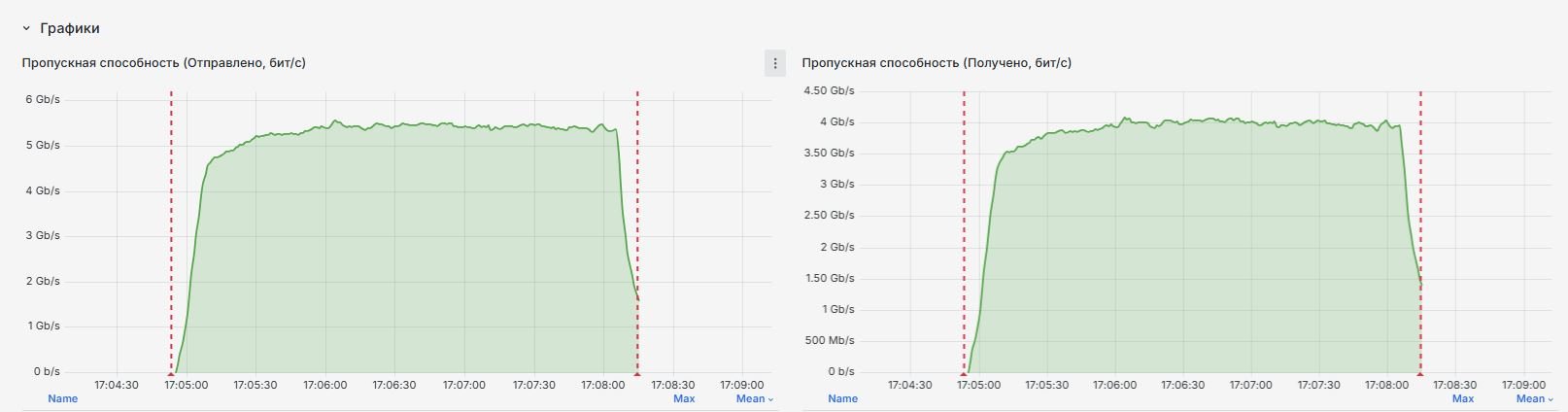

Подскажите пжлст куда копать в следующей ситуации.
используются два порта 100G. между портами поднят vlan 300.
при подаче нагрузки на один порт, на втором видим скорость на 30% ниже.

конфиг 1 порта:
Interface Ethernet1/2/1
 speed-duplex force100g-full
 description NODE4_port1
 flow control
 switchport access vlan 300
конфиг второго порта:
Interface Ethernet1/3/1
 description CE4_port1
 flow control
вывод:
SNR-S4350X-48FC#sh interface ethernet  counter packet
1/2/1     IN   12653522151         905                 949                 0
          OUT  9650377754          1028                10                  0
1/3/1     IN   14320586697         825                 916                 0
          OUT  7952260751          885                 8                   0
SNR-S4350X-48FC#sh interface ethernet 1/2/1
Interface brief:
  Ethernet1/2/1 is up, line protocol is up
  Ethernet1/2/1 is layer 2 port, alias name is NODE4_port1, index is 52
  Hardware is QSFP28,
  PVID is 300
  MTU 10218 bytes, BW 100000000 Kbit
  Time since last status change:0w-1d-14h-59m-33s  (140373 seconds)
  Encapsulation ARPA, Loopback not set
  Force full-duplex, Force 100G
  FlowControl is off, MDI type is auto
Statistics:
  5 minute input rate 454883146 bits/sec, 215592 packets/sec
  5 minute output rate 1321202358 bits/sec, 191003 packets/sec
  The last 5 second input rate 467340034 bits/sec, 221085 packets/sec
  The last 5 second output rate 1349704050 bits/sec, 195463 packets/sec
  Input packets statistics:
    12732070537 input packets, 3066255274759 bytes, 0 no buffer
    12732068680 unicast packets, 949 multicast packets, 908 broadcast packets
    0 input errors, 0 CRC, 0 frame alignment, 0 overrun, 0 ignored,
    0 abort, 0 length error, 0 undersize 0 jabber, 0 fragments, 0 pause frame
  Output packets statistics:
    9719967839 output packets, 8202185784975 bytes, 0 underruns
    9719966800 unicast packets, 10 multicast packets, 1029 broadcast packets
    0 output errors, 0 collisions, 0 late collisions, 0 pause frame
SNR-S4350X-48FC#sh interface ethernet 1/3/1
Interface brief:
  Ethernet1/3/1 is up, line protocol is up
  Ethernet1/3/1 is layer 2 port, alias name is CE4_port1, index is 53
  Hardware is QSFP28,
  PVID is 310
  Time since last status change:0w-1d-15h-0m-39s  (140439 seconds)
Statistics:
  5 minute input rate 1668058336 bits/sec, 227869 packets/sec
  5 minute output rate 304663812 bits/sec, 156627 packets/sec
  The last 5 second input rate 1642667096 bits/sec, 225337 packets/sec
  The last 5 second output rate 301475880 bits/sec, 154946 packets/sec
    14419646919 input packets, 11008908454055 bytes, 0 no buffer
    14419645175 unicast packets, 916 multicast packets, 828 broadcast packets
    8020338634 output packets, 1794697746235 bytes, 0 underruns
    8020337740 unicast packets, 8 multicast packets, 886 broadcast packets
Тесты проводим с Trex. при постановке железной петли на сервере с Трех потерь нет. при прогоне через коммутатор видим потери.
