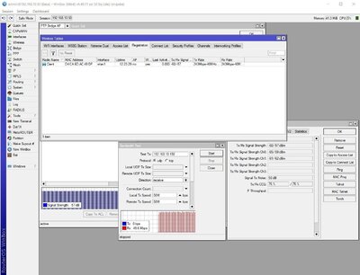

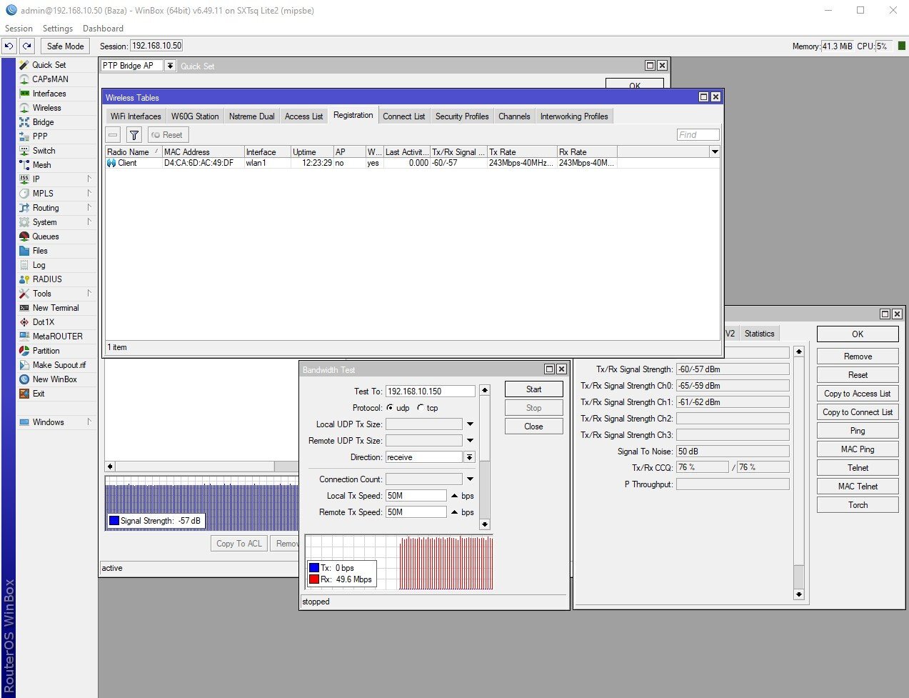

Selent Posted December 30, 2023 Author Posted December 30, 2023 (edited) Получились такие результаты , NV2 , канал 11-ый , Tx Power 1dBm Edited December 30, 2023 by Selent Вставить ник Quote
