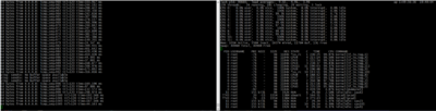

А при этом
last pid: 24969;  load averages:  3.58,  3.38,  3.35                                                                                  up 0+20:43:59  22:28:27
134 threads:   9 running, 103 sleeping, 22 waiting
CPU 0:  0.0% user,  0.0% nice,  100% system,  0.0% interrupt,  0.0% idle
CPU 1:  4.8% user,  0.0% nice, 55.8% system,  0.0% interrupt, 39.4% idle
CPU 2:  5.8% user,  0.0% nice, 42.3% system,  0.0% interrupt, 51.9% idle
CPU 3:  8.7% user,  0.0% nice, 40.4% system,  1.0% interrupt, 50.0% idle
Mem: 90M Active, 1130M Inact, 822M Wired, 243M Buf, 1825M Free
Swap: 7693M Total, 7693M Free
  PID USERNAME    PRI NICE   SIZE    RES STATE    C   TIME     CPU COMMAND
    0 root        -76    -      0   400K CPU0     0 707:30 100.00% kernel{if_io_tqg_0}
   11 root        155 ki31      0    64K RUN      3 870:45  46.49% idle{idle: cpu3}
   11 root        155 ki31      0    64K RUN      2 876:55  45.50% idle{idle: cpu2}
    0 root        -92    -      0   400K -        1 257:31  44.67% kernel{dummynet}
   11 root        155 ki31      0    64K RUN      1 875:44  44.47% idle{idle: cpu1}
    0 root        -76    -      0   400K -        1 210:45  34.48% kernel{if_io_tqg_1}
    0 root        -76    -      0   400K -        2 208:18  33.55% kernel{if_io_tqg_2}
    0 root        -76    -      0   400K CPU3     3 217:59  29.71% kernel{if_io_tqg_3}
Трафика 2.5 гига :(

Всем привет!
Недавно поставил 12.2 , сетевуха Emulex 10G. Два проца E5-2630L 2.4GHz.  Также был удивлён, что загрузка попала в системную.
CPU 0:   0.0% user,  0.0% nice,  0.0% system,  0.0% interrupt,  100% idle
CPU 1:   0.0% user,  0.0% nice,  0.0% system,  1.6% interrupt, 98.4% idle
CPU 2:   0.8% user,  0.0% nice,  0.0% system,  0.8% interrupt, 98.4% idle
CPU 3:   0.0% user,  0.0% nice,  0.0% system,  0.8% interrupt, 99.2% idle
CPU 4:   0.0% user,  0.0% nice, 55.2% system,  0.0% interrupt, 44.8% idle
CPU 5:   0.8% user,  0.0% nice,  4.8% system,  0.0% interrupt, 94.4% idle
CPU 6:   0.0% user,  0.0% nice,  4.8% system,  0.0% interrupt, 95.2% idle
CPU 7:   0.0% user,  0.0% nice,  4.8% system,  0.0% interrupt, 95.2% idle
CPU 8:   0.0% user,  0.0% nice, 24.8% system,  0.0% interrupt, 75.2% idle
CPU 9:   0.0% user,  0.0% nice, 25.6% system,  0.0% interrupt, 74.4% idle
CPU 10:  0.0% user,  0.0% nice, 20.0% system,  0.0% interrupt, 80.0% idle
CPU 11:  0.8% user,  0.0% nice, 21.6% system,  0.0% interrupt, 77.6% idle
Здесь 1k+ PPPoE-сессий. Трафик 1-1,5 гига
Раскидал по ядрам очереди с помощью cpuset. Не сразу только понял какие именно прерывания использует сетевуха.  Может проблемы то и нет или это 12.2 уже доработанная?
Вот как нагрузку выровнять пока не понял. Самая первая из oce0 на 4-м ядре сильнее всех загружена...
Так радуйтесь что в системную, там хоть какие то шансы её распределить, а было бы в прерываниях - почти без вариантов.

   Сделал sysctl net.isr.dispatch=deferred
Получилось весьма интересно. Системная нагрузка упала. Появилась нагрузка от прерываний на 0-4 ядрах, которые  как раз члены пинали до этого момента. Но, иногда нагрузка переходит и на другие ядра. Т.е., система сама как-то решает. Имхо, потенциал производительности тут хороший.
last pid: 12687;  load averages:  1.75,  1.76,  1.71                                                                                           up 25+02:15:00  20:35:04
210 threads:   14 running, 156 sleeping, 40 waiting
CPU 0:   0.0% user,  0.0% nice,  0.0% system,  4.9% interrupt, 95.1% idle
CPU 1:   0.0% user,  0.0% nice,  0.0% system, 30.3% interrupt, 69.7% idle
CPU 2:   0.0% user,  0.0% nice,  0.0% system, 23.8% interrupt, 76.2% idle
CPU 3:   0.0% user,  0.0% nice,  0.0% system, 19.5% interrupt, 80.5% idle
CPU 4:   0.0% user,  0.0% nice, 30.3% system,  0.0% interrupt, 69.7% idle
CPU 5:   0.0% user,  0.0% nice,  2.2% system,  3.8% interrupt, 94.1% idle
CPU 6:   0.0% user,  0.0% nice,  3.2% system,  0.0% interrupt, 96.8% idle
CPU 7:   0.5% user,  0.0% nice,  4.3% system,  0.0% interrupt, 95.1% idle
CPU 8:   0.0% user,  0.0% nice,  9.2% system,  0.0% interrupt, 90.8% idle
CPU 9:   0.5% user,  0.0% nice, 10.3% system,  0.0% interrupt, 89.2% idle
CPU 10:  2.2% user,  0.0% nice,  8.1% system,  0.0% interrupt, 89.7% idle
CPU 11:  0.0% user,  0.0% nice,  9.2% system,  0.0% interrupt, 90.8% idle
Mem: 20M Active, 771M Inact, 1760M Wired, 1047M Buf, 13G Free
Swap: 4096M Total, 4096M Free
   11 root        155 ki31     0B   192K CPU11   11 543.9H  93.86% idle{idle: cpu11}
   11 root        155 ki31     0B   192K CPU9     9 542.6H  93.72% idle{idle: cpu9}
   11 root        155 ki31     0B   192K CPU6     6 585.7H  93.68% idle{idle: cpu6}
   11 root        155 ki31     0B   192K CPU7     7 585.1H  93.60% idle{idle: cpu7}
   11 root        155 ki31     0B   192K CPU10   10 544.4H  93.27% idle{idle: cpu10}
   11 root        155 ki31     0B   192K CPU0     0 594.7H  93.09% idle{idle: cpu0}
   11 root        155 ki31     0B   192K CPU5     5 573.3H  92.12% idle{idle: cpu5}
   11 root        155 ki31     0B   192K CPU8     8 515.3H  90.53% idle{idle: cpu8}
   11 root        155 ki31     0B   192K CPU3     3 590.0H  82.24% idle{idle: cpu3}
   12 root        -72    -     0B   640K WAIT     0 560:55  78.96% intr{swi1: netisr 0}
   11 root        155 ki31     0B   192K RUN      2 594.4H  76.90% idle{idle: cpu2}
   11 root        155 ki31     0B   192K CPU4     4 447.5H  71.64% idle{idle: cpu4}
   11 root        155 ki31     0B   192K CPU1     1 594.5H  69.41% idle{idle: cpu1}
    0 root        -92    -     0B   928K -        4 159.7H  28.10% kernel{oce0 taskq}
    0 root        -92    -     0B   928K -        8  90.5H   9.25% kernel{oce1 taskq}
    0 root        -92    -     0B   928K -       10  59.3H   5.79% kernel{oce1 taskq}
    0 root        -92    -     0B   928K -       11  59.7H   5.55% kernel{oce1 taskq}
    0 root        -92    -     0B   928K -        7 885:44   5.41% kernel{oce0 taskq}
    0 root        -92    -     0B   928K CPU6     6 847:20   5.32% kernel{oce0 taskq}
 2268 root         52    0    95M    33M select   7 691:41   4.98% mpd5{mpd5}
    0 root        -92    -     0B   928K -        9  60.9H   4.69% kernel{oce1 taskq}
   12 root        -60    -     0B   640K WAIT     1 826:18   3.89% intr{swi4: clock (0)}
    0 root        -92    -     0B   928K -        5 789:04   3.26% kernel{oce0 taskq}
    0 root        -92    -     0B   928K -        5  70:14   0.16% kernel{dummynet}
   29 root        -16    -     0B    16K -       11  53:00   0.13% rand_harvestq

Сообразно кол-ву сессий увеличился и пропускной трафик. Я же не синтетику гонял, а реальных абонентов. В данный момент в пике пропускает 4.5-5 Gbps
pps не снимаю. НАТа нет, только терминация.
