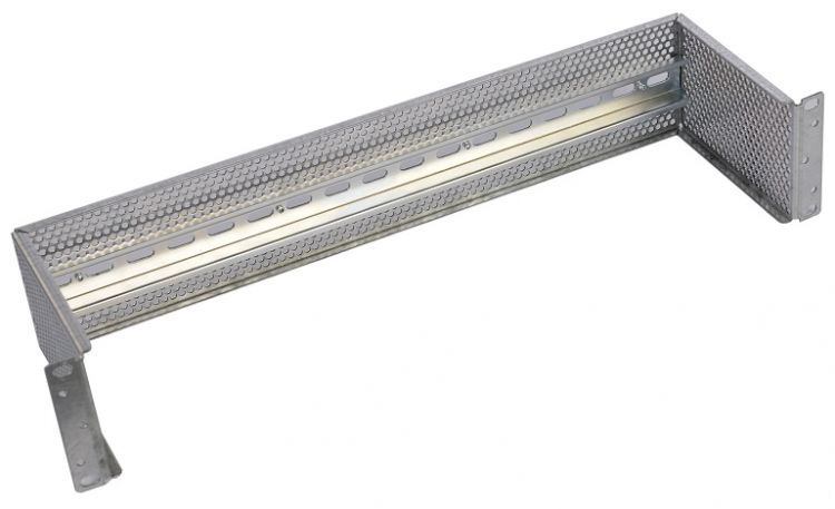

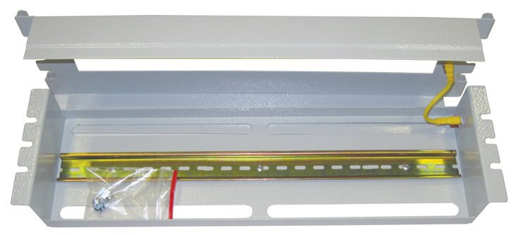

LostSoul Posted February 26, 2019 Author Posted February 26, 2019 Помоги себе сам. ЦМО КП-АВ ЦМО STK-RACKMNT-2955 Вставить ник Quote
Omnyman Posted February 26, 2019 Posted February 26, 2019 https://shop.nag.ru/catalog/14019.SHkafy-telekommunikatsionnye/14038.Aksessuary/12807.SNR-PDR-19 Вставить ник Quote
Crazy_Max Posted February 26, 2019 Posted February 26, 2019 http://www.itk-group.ru/produktsiya/catalog/?page=detail&article=EDP35-3U Вставить ник Quote
