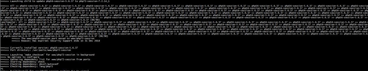

hsvt Posted February 6, 2019 Posted February 6, 2019 (edited) Ага, с php5.6 и 7.1 они тоже отлично придумали. 20180905: AFFECTS: users of lang/php56 AUTHOR: tz@FreeBSD.org The default version of PHP has been switched from 5.6 to 7.1. If you use binary packages you should make a list of php packages before running 'pkg upgrade': # pkg info php5\* > ~/installed-php-ports-list After the upgrade, check with such list if all your php extensions are still installed, and reinstall them if needed. If you use mod_php56 you need to deinstall it and install mod_php71. Для тех кто portmaster использует больше давать рекомендации как переехать на новый php не нужно? Ну типа сами додумайте с portmaster -o и пр. Портмастеру крышу посносило, пока pkg delete -f не сделал...да и постоянно на какие то грабли наступаешь в портах, make reinstall так и поломали до сих пор. Perl до 5.28 дефолт сделали, nfsen теперь сломался. /usr/local/etc/rc.d/nfsen status Useless use of private array in void context at /usr/local/libexec/nfsen/NfSenRRD.pm line 287. Useless use of a constant ("--imgformat") in void context at /usr/local/libexec/nfsen/NfSenRRD.pm line 287. Useless use of a constant ("PNG") in void context at /usr/local/libexec/nfsen/NfSenRRD.pm line 287. Useless use of a constant ("--title") in void context at /usr/local/libexec/nfsen/NfSenRRD.pm line 287. Useless use of a constant ("--vertical-label") in void context at /usr/local/libexec/nfsen/NfSenRRD.pm line 287. Useless use of a constant ("--start") in void context at /usr/local/libexec/nfsen/NfSenRRD.pm line 287. Useless use of a constant ("--end") in void context at /usr/local/libexec/nfsen/NfSenRRD.pm line 287. Useless use of a constant ("-w") in void context at /usr/local/libexec/nfsen/NfSenRRD.pm line 287. Useless use of a constant ("576") in void context at /usr/local/libexec/nfsen/NfSenRRD.pm line 287. Useless use of a constant ("-h") in void context at /usr/local/libexec/nfsen/NfSenRRD.pm line 287. Useless use of a constant ("200") in void context at /usr/local/libexec/nfsen/NfSenRRD.pm line 287. Useless use of private array in void context at /usr/local/libexec/nfsen/NfSenRRD.pm line 287. Useless use of string in void context at /usr/local/libexec/nfsen/NfSenRRD.pm line 287. Useless use of string in void context at /usr/local/libexec/nfsen/NfSenRRD.pm line 287. Useless use of string in void context at /usr/local/libexec/nfsen/NfSenRRD.pm line 287. Useless use of string in void context at /usr/local/libexec/nfsen/NfSenRRD.pm line 287. Короче лишний раз трогать уже желания всё меньше и меньше ) Edited February 6, 2019 by hsvt Вставить ник Quote
Ivan_83 Posted February 6, 2019 Posted February 6, 2019 1 час назад, alibek сказал: Либо подключать внешние engines, либо для РКН держать старую версию. Вот что за люди такие, нет чтобы взять и добавить к порту опцию чтобы он опенссл с этим сраным энжином мог собирать, нет, они будут ныть как всё плохо и сидеть на старье. Вообще там для госта уже есть опция, но она в разделе block ciphers, не факт что этого хватит для проверки подписи, может там один гост89. опенссл111 считается эксперементальным пока что, судя по названию порта. 18 минут назад, hsvt сказал: Портмастеру крышу посносило, пока pkg delete -f не сделал...да и постоянно на какие то грабли наступаешь в портах, make reinstall так и поломали до сих пор. Портмастер всё грозятся переписать, а так вообще выкинуть хотели при добавлении флаверсов, если бы я там возмущатся не начал то похоже пользователей других в рассылках и нет, все на пудреле сидят. Грабли не постоянно а периодически, портмастер не понимает что порт надо снести чтобы другое собралось. 25 минут назад, hsvt сказал: Ага, с php5.6 и 7.1 они тоже отлично придумали. Так а кто будет латать дыры в этом мусоре? У меня вон по работе джанга юзается, щас версия которая у нас устарела и снесена из портов, потому что апстрим больше её не суппортит. С пхп я вообще не понимаю в чём проблема, поставил последний и не паришься, даже мой говнокод почти не пришлось править под 7.1, а уж от нормальных людей типа маускуладмин и докувики и подавно. Вставить ник Quote
