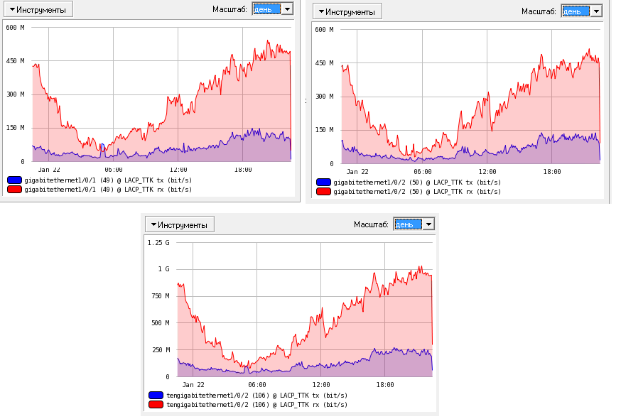

myth Posted January 22, 2018 Posted January 22, 2018 Всем привет. Собрали с аплинком LACP. С нашей стороны LACPом командует Eltex MES2324B. Проблема проявляется в том, что не могу нагрузить канал свыше 1 гигабита. Выглядит это так, как будто юзеры столько не хотят. Но скорости в вечернее время сильно проседают Конфиг Элтекса #do sh run no spanning-tree ! vlan database vlan 2,2001,4092-4093 exit ! Port-Channel load-balance src-dst-mac-ip-port ! logging host 192.168.35.2 logging console alerts ! username admin password encrypted XXXXX privilege 15 ! snmp-server server encrypted snmp-server community hXKI/nU2kUzqKGixTrnUEJk2X9/GnPd4ihiuEf9vIco= ro view Default ! aaa authentication login admin local enable aaa authentication enable admin line enable ! clock timezone 3 0 minutes 0 clock source sntp ! sntp unicast client enable sntp unicast client poll sntp server 192.168.35.2 ! interface gigabitethernet1/0/1 flowcontrol auto description TTK channel-group 1 mode auto exit ! interface gigabitethernet1/0/2 flowcontrol auto description TTK channel-group 1 mode auto exit ! interface gigabitethernet1/0/12 description "Mirror RKN" port monitor tengigabitethernet1/0/1 rx exit ! interface gigabitethernet1/0/13 description MGMT switchport mode trunk switchport trunk allowed vlan add 2 switchport trunk native vlan 2001 exit ! interface gigabitethernet1/0/23 description "IPMI Border" switchport access vlan 2001 exit ! interface tengigabitethernet1/0/1 description "Border IN (WAN)" switchport access vlan 4093 exit ! interface tengigabitethernet1/0/2 description "Border OUT (LAN)" switchport mode trunk switchport trunk allowed vlan add 2,2001 switchport trunk native vlan 4092 exit ! interface tengigabitethernet1/0/4 switchport access vlan 4092 exit ! interface Port-channel1 flowcontrol auto loopback-detection enable description TTK switchport access vlan 4093 exit ! interface vlan 2 name BGP exit ! interface vlan 2001 ip address 192.168.35.37 255.255.240.0 exit ! interface vlan 4092 name "Link NAS" exit ! interface vlan 4093 name TTK exit ! ! Да, трафик по протам размазывается примерно поровну, судя по SNMP с портов. Как видно из конфига, свитч занимается зеркалом для ркн и перекладыванием пакетов из Po1 в 10г Вставить ник Quote

myth Posted January 22, 2018 Author Posted January 22, 2018 pps не ведутся. По трафику приложил. Скорость бонда должна быть 1500 мегабит Вставить ник Quote
vurd Posted January 22, 2018 Posted January 22, 2018 Рисуйте по ппс. Я не даром говорю, такие полки бывает не видно по объему, но видно по пакетам. Вставить ник Quote
myth Posted January 22, 2018 Author Posted January 22, 2018 Результирующее PPS, проходящее через сервера не соответствует 1,5г Вставить ник Quote
vurd Posted January 22, 2018 Posted January 22, 2018 А вообще балансируется у вас всё четко, 99% что проблема не на свитче, а где-то дальше или раньше. Вставить ник Quote
