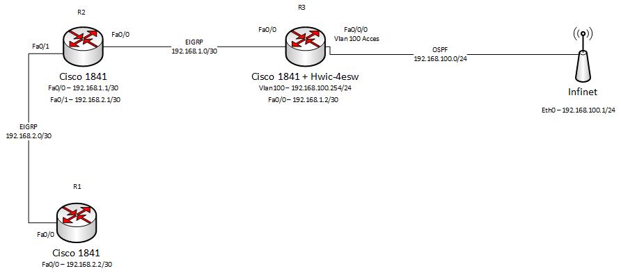

fractal Posted August 26, 2016 Author Posted August 26, 2016 (edited) Вообщем вот схема, в итоге конфигурация такая Infinet #Interfaces parameters ifc lo0 127.0.0.1/32 ifc eth0 media auto mtu 1500 up ifc eth0 192.168.100.1/24 ifc rf5.0 down ifc rf5.0 192.168.200.1/28 #OSPF configuration ospf start ospf interface eth0 ospf interface lo0 ospf interface null0 ospf interface rf5.0 ospf router ospf passive-interface lo0 ospf passive-interface null0 ospf auto-interface rf5.0 area 0.0.0.0 ospf network 192.168.100.0/24 area 0.0.0.0 ospf end R3 interface FastEthernet0/0 ip address 192.168.1.2 255.255.255.252 duplex auto speed auto ! interface FastEthernet0/1 no ip address shutdown duplex auto speed auto ! interface FastEthernet0/0/0 switchport access vlan 100 ! interface FastEthernet0/0/1 switchport trunk allowed vlan 1,2,1002-1005 switchport mode trunk shutdown ! interface FastEthernet0/0/2 ! interface FastEthernet0/0/3 ! interface FastEthernet0/1/0 ! interface FastEthernet0/1/1 ! interface FastEthernet0/1/2 ! interface FastEthernet0/1/3 ! interface Vlan1 no ip address ! interface Vlan100 description -- mngt -- ip address 192.168.100.254 255.255.255.0 ! router eigrp 100 traffic-share min across-interfaces redistribute connected metric 102400 1 255 1 1500 redistribute static metric 102400 1 255 1 1500 redistribute ospf 100 metric 102400 1 255 1 1500 passive-interface default no passive-interface FastEthernet0/0 network 192.168.1.0 0.0.0.3 no auto-summary neighbor 192.168.1.1 FastEthernet0/0 ! router ospf 100 log-adjacency-changes traffic-share min across-interfaces passive-interface default no passive-interface Vlan100 network 192.168.1.0 0.0.0.3 area 0 network 192.168.100.0 0.0.0.255 area 0 R2 interface FastEthernet0/0 ip address 192.168.1.1 255.255.255.252 duplex auto speed auto ! interface FastEthernet0/1 ip address 192.168.2.1 255.255.255.252 duplex auto speed auto ! router eigrp 100 traffic-share min across-interfaces redistribute connected metric 102400 1 255 1 1500 redistribute static metric 102400 1 255 1 1500 passive-interface default no passive-interface FastEthernet0/0 no passive-interface FastEthernet0/1 network 192.168.1.0 0.0.0.3 network 192.168.2.0 0.0.0.3 no auto-summary neighbor 192.168.1.2 FastEthernet0/0 neighbor 192.168.2.2 FastEthernet0/1 R1 interface FastEthernet0/0 ip address 192.168.2.2 255.255.255.252 duplex auto speed auto ! interface FastEthernet0/1 ip address 192.168.3.1 255.255.255.252 duplex auto speed auto ! router eigrp 100 traffic-share min across-interfaces redistribute connected metric 102400 1 255 1 1500 redistribute static metric 102400 1 255 1 1500 passive-interface default no passive-interface FastEthernet0/0 network 192.168.2.0 0.0.0.3 no auto-summary neighbor 192.168.2.1 FastEthernet0/0 с R1 пингуются все сети инфинета, а инфинет пингует только подсеть 192.168.1.0/30 и далее не ходит, если на инфинете прописать route add default 192.168.1.254 (Vlan100 - Управление инфинетом) то он начинает пинговать все сети Edited August 26, 2016 by fractal Вставить ник Quote

В Густелёв Posted September 1, 2016 Posted September 1, 2016 Мы настроили на нашем стенде ваш сетап. Вот наши мысли: 1. Зачем настроено перераспределение маршрутов на R2 и R1? Предлагаю убрать. 2. На R3 сейчас все настроено таким образом, что в процесс EIGRP поступают маршруты из OSPF, но не наоборот. Поэтому на Инфинет нет информации о сетях 192.168.2.1/30 и 192.168.1.0/30 Если убрать на R1 вот эти куски: redistribute connected metric 102400 1 255 1 1500redistribute static metric 102400 1 255 1 1500 redistribute ospf 100 metric 102400 1 255 1 1500 и добавить вот этот: router ospf 100redistribute eigrp 100 metric 100 subnets router eigrp 100 net 192.168.100.0 0.0.0.255 Тогда на Инфинете мы увидим упомянутые сети: net -rRouting tables Destination Gateway Flags Refs Use Interface 127.0.0.1 127.0.0.1 UH 3 35 lo0 192.168.1.0/24 192.168.100.254 UG3 0 0 svi1 192.168.2.0/24 192.168.100.254 UG3 0 0 svi1 192.168.100.0/24 link#5 UC 0 0 svi1 192.168.100.254 link#5 UHL 2 0 svi1 224.0.0.0/8 127.0.0.1 UGS 1 1085 lo0 И сможем пропинговать дальний конец: #1> ping 192.168.2.2ping (192.168.2.2): 56 data bytes 64 bytes from 192.168.2.2: icmp_seq=0 ttl=253 time=50.322 ms 64 bytes from 192.168.2.2: icmp_seq=1 ttl=253 time=37.550 ms 64 bytes from 192.168.2.2: icmp_seq=2 ttl=253 time=37.796 ms 64 bytes from 192.168.2.2: icmp_seq=3 ttl=253 time=41.325 ms 64 bytes from 192.168.2.2: icmp_seq=4 ttl=253 time=43.793 ms Вставить ник Quote
fractal Posted September 1, 2016 Author Posted September 1, 2016 Мы настроили на нашем стенде ваш сетап. Вот наши мысли: 1. Зачем настроено перераспределение маршрутов на R2 и R1? Предлагаю убрать. 2. На R3 сейчас все настроено таким образом, что в процесс EIGRP поступают маршруты из OSPF, но не наоборот. Поэтому на Инфинет нет информации о сетях 192.168.2.1/30 и 192.168.1.0/30 Если убрать на R1 вот эти куски: redistribute connected metric 102400 1 255 1 1500redistribute static metric 102400 1 255 1 1500 redistribute ospf 100 metric 102400 1 255 1 1500 и добавить вот этот: router ospf 100redistribute eigrp 100 metric 100 subnets router eigrp 100 net 192.168.100.0 0.0.0.255 Тогда на Инфинете мы увидим упомянутые сети: net -rRouting tables Destination Gateway Flags Refs Use Interface 127.0.0.1 127.0.0.1 UH 3 35 lo0 192.168.1.0/24 192.168.100.254 UG3 0 0 svi1 192.168.2.0/24 192.168.100.254 UG3 0 0 svi1 192.168.100.0/24 link#5 UC 0 0 svi1 192.168.100.254 link#5 UHL 2 0 svi1 224.0.0.0/8 127.0.0.1 UGS 1 1085 lo0 И сможем пропинговать дальний конец: #1> ping 192.168.2.2ping (192.168.2.2): 56 data bytes 64 bytes from 192.168.2.2: icmp_seq=0 ttl=253 time=50.322 ms 64 bytes from 192.168.2.2: icmp_seq=1 ttl=253 time=37.550 ms 64 bytes from 192.168.2.2: icmp_seq=2 ttl=253 time=37.796 ms 64 bytes from 192.168.2.2: icmp_seq=3 ttl=253 time=41.325 ms 64 bytes from 192.168.2.2: icmp_seq=4 ttl=253 time=43.793 ms перераспределение у нас настроено, статик и конектед также нужны т.к. основной протокол у нас eigrp, по cisco вроде нашли проблему 1. как Вы верно заметили, забыли редистрибьют прописать в ospf из eigrp 2. неадекватная прошивка на Cisco, маршруты то появлялись то пропадали Спасибо за оперативную сборку и проверку на стенде Вставить ник Quote
В Густелёв Posted September 1, 2016 Posted September 1, 2016 Да, не забываем про http://www.cisco.com/c/en/us/support/docs/ip/enhanced-interior-gateway-routing-protocol-eigrp/8606-redist.html#avoidredist - чтобы не было кольца. Вставить ник Quote
