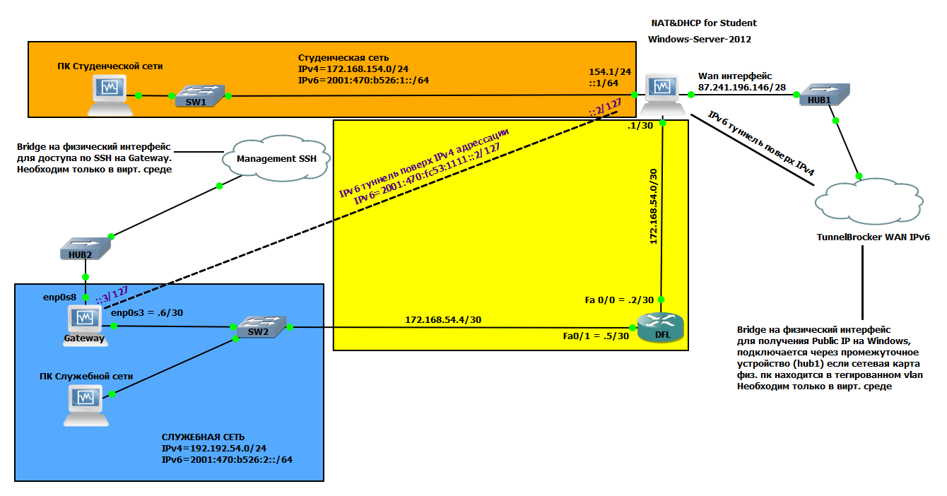

fractal Posted June 16, 2016 Posted June 16, 2016 Пытаюсь настроить dhcp6 relay на ubuntu, перед этим выполнил настройку dhcp4 relay ubuntu, она работает, DHCP крутиться на windows server 2012. сделал так, создал isc-dhcp6-relay в /etc/default/ # Defaults for isc-dhcp6-relay initscript # sourced by /etc/init/isc-dhcp6-relay.conf # # This is a POSIX shell fragment # # What interfaces should the DHCP relay forward requests to? [color="#FFFF00"]тут интерфейс который смотрит на клиента UPPER_INTERFACES="enp0s3"[/color] # On what interfaces should the DHCP relay (dhrelay) serve DHCP requests? [color="#FFFF00"]тут у меня туннель ipv6 over ipv4[/color] LOWER_INTERFACES="win6to4" # Additional options that are passed to the DHCP relay daemon? OPTIONS="" создал /etc/init.d/isc-dhcp6-relay #!/bin/sh # # ### BEGIN INIT INFO # Provides: isc-dhcp6-relay # Required-Start: $remote_fs $network # Required-Stop: $remote_fs $network # Should-Start: $local_fs # Should-Stop: $local_fs # Default-Start: 2 3 4 5 # Default-Stop: 0 1 6 # Short-Description: DHCP relay # Description: Dynamic Host Configuration Protocol Relay ### END INIT INFO # It is not safe to start if we don't have a default configuration... if [ ! -f /etc/default/isc-dhcp6-relay ]; then echo "/etc/default/isc-dhcp6-relay does not exist! - Aborting..." echo "Run 'dpkg-reconfigure isc-dhcp6-relay' to fix the problem." exit 1 fi # Source init functions . /lib/lsb/init-functions # Read init script configuration (interfaces the daemon should listen on # and the DHCP server we should forward requests to.) [ -f /etc/default/isc-dhcp6-relay ] && . /etc/default/isc-dhcp6-relay # Build command line for interfaces (will be passed to dhrelay below.) IFCMD="" if test "$INTERFACES" != ""; then for I in $INTERFACES; do IFCMD=${IFCMD}"-i "${I}" " done fi DHCRELAYPID=/var/run/dhcrelay6.pid case "$1" in start) start-stop-daemon --start --quiet --pidfile $DHCRELAYPID \ --exec /usr/sbin/dhcrelay -- -q $OPTIONS $IFCMD $SERVERS ;; stop) start-stop-daemon --stop --quiet --pidfile $DHCRELAYPID ;; restart | force-reload) $0 stop sleep 2 $0 start ;; *) echo "Usage: /etc/init.d/isc-dhcp6-relay {start|stop|restart|force-reload}" exit 1 esac exit 0 при старте [....] Starting isc-dhcp6-relay (via systemctl): isc-dhcp6-relay.serviceFailed to start isc-dhcp6-relay.service: Unit isc-dhcp6-relay.service not found. failed! вот текущая топология в скрине Вставить ник Quote

fractal Posted June 19, 2016 Author Posted June 19, 2016 Интерфейс такой есть, это туннель до сервера windows через который ходит ipv6. Стартовал именно через unit.d Вставить ник Quote
