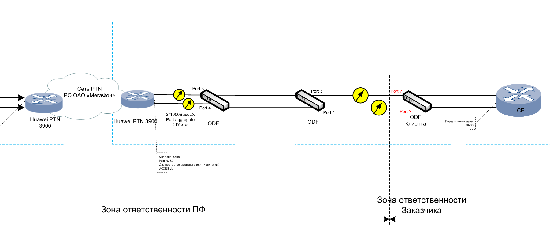

hpswgprk Posted November 13, 2015 Posted November 13, 2015 Здравствуйте. Мы используем Q-TECH QSW-8300-52 вместо L3 коммутатора. В него входит аплинк двумя отдельными каналами. Настроено вот так: QSW-8300-52F(config)# show port-group brief ID: port group number; Mode: port group mode such as on active or passive; Ports: different types of port number of a port group, the first is selected ports number, the second is standby ports number, and the third is unselected ports number. ID Mode Partner ID Ports Load-balance ------------------------------------------------------------------ 1 passive 0x8000,28-6e-d4-f6-5e-da 2,0,0 dst-src-mac QSW-8300-52F(config)# show port-group detail Flags: A -- LACP_Activity, B -- LACP_timeout, C -- Aggregation, D -- Synchronization, E -- Collecting, F -- Distributing, G -- Defaulted, H -- Expired Port-group number: 1, Mode: passive, Load-balance: dst-src-mac Port-group detail information: System ID: 0x8000,00-1f-ce-5e-ed-3b Local: Port Status Priority Oper-Key Flag ----------------------------------------------------------- Ethernet1/0/42 Selected 32768 1 {CDEF} Ethernet1/0/44 Selected 32768 1 {CDEF} Remote: Actor Partner Priority Oper-Key SystemID Flag -------------------------------------------------------------------------------- Ethernet1/0/42 7686 32768 288 0x8000,28-6e-d4-f6-5e-da {ABCDEF} Ethernet1/0/44 7687 32768 288 0x8000,28-6e-d4-f6-5e-da {ABCDEF} QSW-8300-52F(config)# show interface port-channel 1 Interface brief: Port-Channel1 is up, line protocol is up Port-Channel1 is layer 2 port, alias name is (null), index is 65 Port-Channel1 is LAG port, member is : Ethernet1/0/42 Ethernet1/0/44 Hardware is EtherChannel, address is 00-1f-ce-5e-ed-3b PVID is 105 MTU 1500 bytes, BW 2000000 Kbit Time since last status change:1w-1d-10h-59m-38s (730778 seconds) Encapsulation ARPA, Loopback not set Auto-duplex: Negotiation full-duplex, Auto-speed: Negotiation 2G bits FlowControl is off, MDI type is auto Результат этой агрегации уходит на мой BGP-маршрутизатор где подымается сессия с аплинком. Суть проблемы: агрегация есть, балансировки нет и в середине дня у меня ровное плато в 1G, а собрано-то в 2G. Лыжи не едут или я? Вставить ник Quote
mikezzzz Posted November 13, 2015 Posted November 13, 2015 (edited) а у вас там точно разные SRC/DST mac фрэймы летают? если это point2point, то вряд ли.. Edited November 13, 2015 by mikezzzz Вставить ник Quote

hpswgprk Posted November 13, 2015 Author Posted November 13, 2015 Прошу прощения, не указал на схеме, что ip терменируется на BGP-маршрутизаторе, и он идёт после кьютека, на кьютеке ip не терменируются. Вставить ник Quote
Butch3r Posted November 15, 2015 Posted November 15, 2015 Да какая разница, поменяйте с обеих сторон на src-dst-ip и всё будет норм. Вставить ник Quote
