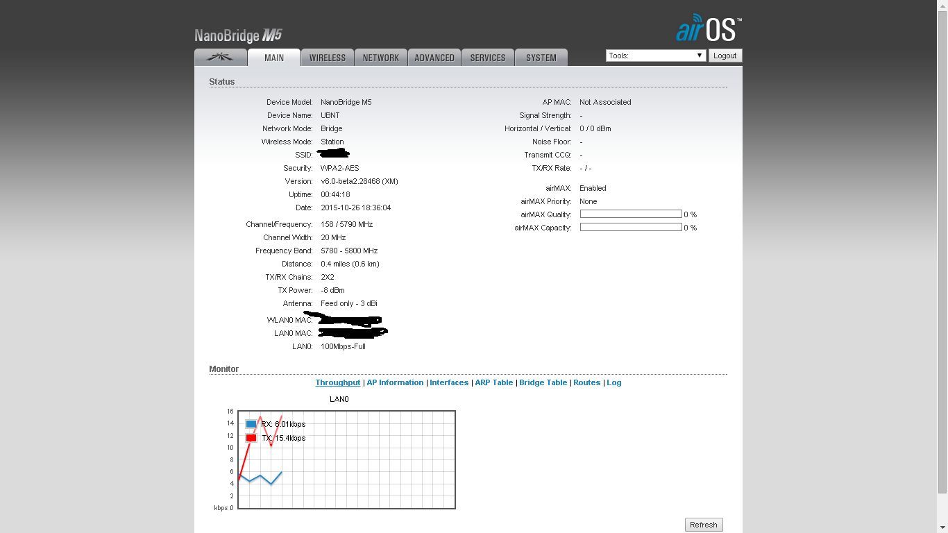

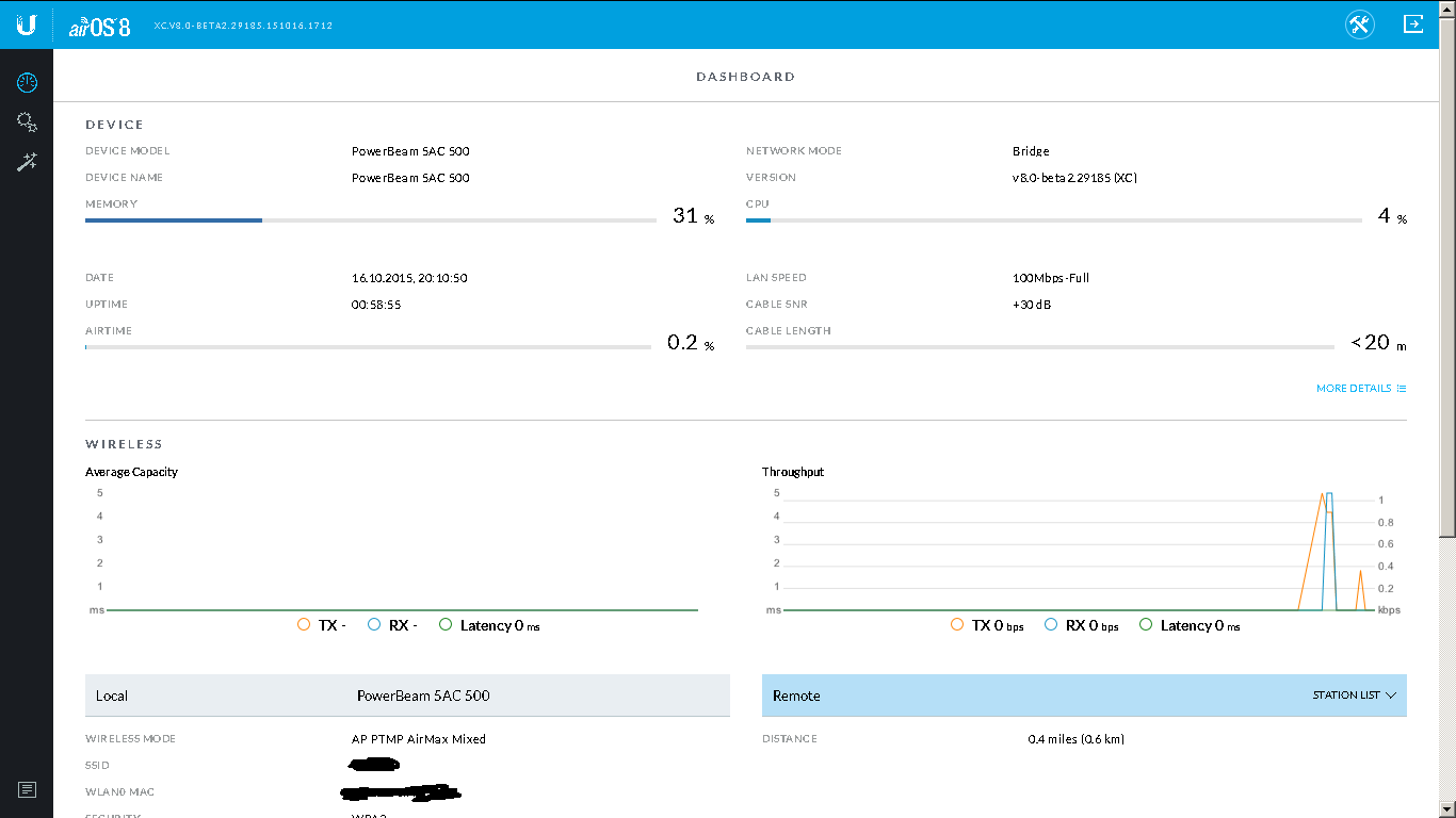

Taranenko81 Posted October 26, 2015 Posted October 26, 2015 https://yadi.sk/d/_weVdXUHk2UoD 26.10.2015 17:25 6,8 МБ TI.v6.0-beta2.28468.151016.1848.bin WA.v8.0-beta2.29185.151016.1706.bin XM.v6.0-beta2.28468.151016.1910.bin XW.v6.0-beta2.28468.151016.1859.bin Вставить ник Quote
kvartal1 Posted October 26, 2015 Posted October 26, 2015 https://yadi.sk/d/_weVdXUHk2UoD 26.10.2015 17:25 6,8 МБ TI.v6.0-beta2.28468.151016.1848.bin WA.v8.0-beta2.29185.151016.1706.bin XM.v6.0-beta2.28468.151016.1910.bin XW.v6.0-beta2.28468.151016.1859.bin Подождем отзывов, там кажись страна 5000 не прокатывает... Вставить ник Quote
