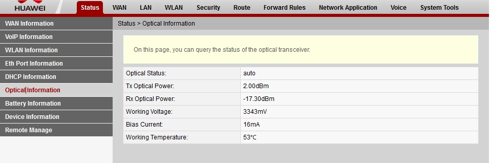

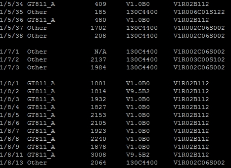

whitenoise Posted August 7, 2015 Posted August 7, 2015 (edited) level 0 / olt port / 1:2 level 1 / distribution box / 1:8 level 2 / subscriber box / 1:4 or 1:8 OLT GWDelight, XDK, BDCOM onu gwdelight 811, xdk, huawei HG8245 Bulgaria, near capital / 5 - 35km / Edited August 8, 2015 by whitenoise Вставить ник Quote
