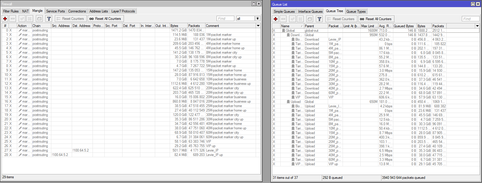

Несколько правил маркировки пакетов:
 0   chain=postrouting action=mark-connection new-connection-mark=users-local passthrough=yes src-address-list=!masquerade
    dst-address-list=masquerade
1   ;;; 1M-packet marker
    chain=postrouting action=mark-packet new-packet-mark=1M_packets passthrough=no dst-address-list=1M_address_list
2   ;;; 1M-packet marker up
    chain=postrouting action=mark-packet new-packet-mark=1M_packets_up passthrough=no src-address-list=1M_address_list
Где искать проблему?
