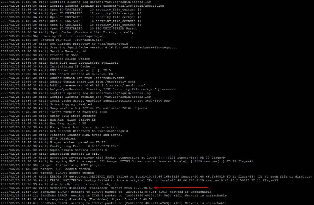

2022/03/09 08:42:51 kid1| Pinger socket opened on FD 26 2022/03/09 08:42:51 kid1| Configuring Parent 10.0.48.52/3128/3130 2022/03/09 08:42:51 kid1| Squid plugin modules loaded: 0 2022/03/09 08:42:51 kid1| Adaptation support is off. 2022/03/09 08:42:51 kid1| Accepting HTTP Socket connections at conn13 local=[::]:3130 remote=[::] FD 22 flags=9 2022/03/09 08:42:51 kid1| Accepting NAT intercepted HTTP Socket connections at conn15 local=[::]:3128 remote=[::] FD 23 flags=41 2022/03/09 08:42:51 kid1| Accepting NAT intercepted SSL bumped HTTPS Socket connections at conn17 local=[::]:3129 remote=[::] FD 24 flags=41 2022/03/09 08:42:52| pinger: Initialising ICMP pinger ... 2022/03/09 08:42:52| pinger: ICMP socket opened. 2022/03/09 08:42:52| pinger: ICMPv6 socket opened 2022/03/09 08:42:52 kid1| storeLateRelease: released 0 objects 2022/03/09 08:43:28 kid1| ICP is disabled! Cannot send ICP request to peer. 2022/03/09 08:57:34 kid1| ERROR: NF getsockopt(ORIGINAL_DST) failed on conn25 local=10.48.46.165:3128 remote=10.48.46.2:50975 FD 11 flags=33: (92) Protocol not available listening port: 3128 2022/03/09 08:57:34 kid1| ERROR: NAT/TPROXY lookup failed to locate original IPs on conn25 local=10.48.46.165:3128 remote=10.48.46.2:50975 FD 11 flags=33 listening port: 3128 2022/03/09 08:57:35 kid1| ERROR: NF getsockopt(ORIGINAL_DST) failed on conn26 local=10.48.46.165:3129 remote=10.48.46.2:50979 FD 11 flags=33: (92) Protocol not available listening port: 3129 2022/03/09 08:57:35 kid1| ERROR: NAT/TPROXY lookup failed to locate original IPs on conn26 local=10.48.46.165:3129 remote=10.48.46.2:50979 FD 11 flags=33 listening port: 3129 Udavf, в общем, если схема маршрутизатор -> DNAT -> сервер Squid работать не будет. Нужно Squid делать на самом маршрутизаторе. -

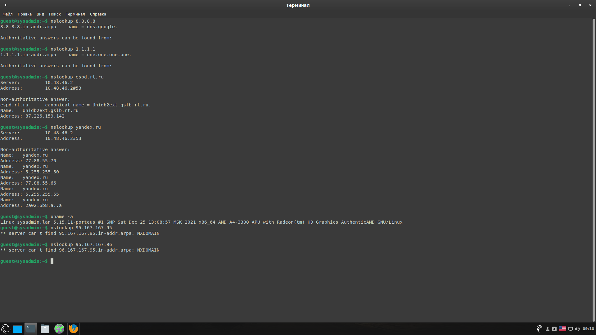

так и есть http_port 3128 accel vhost allow-direct https_port 3129 intercept ssl-bump cert=/etc/squid/squidCA.pem never_direct allow all sslproxy_cert_error allow all ssl_bump peek all ssl_bump splice all sslcrtd_program /usr/libexec/security_file_certgen -s /var/cache/squid/ssl_db -M 4MB cache_peer 10.0.48.52 parent 3128 0 no-query default nslookup проверю. Трафик DNAT-ом перекидываю firewall-ом маршрутизатора 80 порт на 3128 443 порт на 3129 в мой локальный proxy сервер Squid. В логе получаю: 2022/02/25 12:36:38 kid1| Pinger socket opened on FD 25 2022/02/25 12:36:38 kid1| Configuring Parent 10.0.48.52/3128/0 2022/02/25 12:36:38 kid1| Squid plugin modules loaded: 0 2022/02/25 12:36:38 kid1| Adaptation support is off. 2022/02/25 12:36:38 kid1| Accepting reverse-proxy HTTP Socket connections at local=[::]:3128 remote=[::] FD 22 flags=9 2022/02/25 12:36:38 kid1| Accepting NAT intercepted SSL bumped HTTPS Socket connections at local=[::]:3129 remote=[::] FD 23 flags=41 2022/02/25 12:36:38| pinger: Initialising ICMP pinger ... 2022/02/25 12:36:38| pinger: ICMP socket opened. 2022/02/25 12:36:38| pinger: ICMPv6 socket opened 2022/02/25 12:36:38 kid1| ERROR: NF getsockopt(ORIGINAL_DST) failed on local=10.48.46.165:3129 remote=10.48.46.2:50815 FD 11 flags=33: (2) No such file or directory 2022/02/25 12:36:38 kid1| ERROR: NAT/TPROXY lookup failed to locate original IPs on local=10.48.46.165:3129 remote=10.48.46.2:50815 FD 11 flags=33 2022/02/25 12:36:39 kid1| storeLateRelease: released 0 objects 2022/02/25 12:37:32 kid1| temporary disabling (Forbidden) digest from 10.0.48.52 2022/02/25 12:37:32| SendEcho ERROR: sending to ICMPv6 packet to [2a02:28:2:e::2]: (101) Network is unreachable 2022/02/25 12:38:12| SendEcho ERROR: sending to ICMPv6 packet to [2a00:1450:4010:c09::5e]: (101) Network is unreachable 2022/02/25 12:42:32 kid1| temporary disabling (Forbidden) digest from 10.0.48.52 2022/02/25 12:44:01| SendEcho ERROR: sending to ICMPv6 packet to [2a02:26f0:d0::217:a763]: (101) Network is unreachable Погуглил и нашел такую трактовку: > 2006/09/29 21:41:32| temporary disabling (Forbidden) digest from squid2 > 2006/09/29 21:42:32| temporary disabling (Forbidden) digest from squid3 Looks like the squid2 and squid3 does not allow digest exchanges. -
